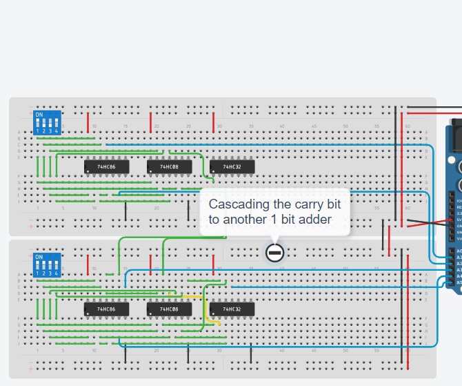

Step 2: Placing the Components on the Breadboard
With the theory out of the way, let's begin with the physical construction of the project!
You can place the components as shown on the breadboard, or you may do it to your own convenience. What is required for you to follow is to place 2 1,000 Ohm resistors directly with each end of the button. Connect one terminal of the push button to 5V through a resistor and connect the other to the ground through resistor. The displays and the CD4511 chips can be placed anywhere within your liking, but I found that keeping them within close distance made for easier wiring. Remember to connect your power lines and ground lines correctly.
