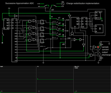

Step 2: The Components
This is an example of a successive approximation analogue to digital converter using the charge redistribution design with binary-weighted, switched capacitors.
The sections of the ADC are shown above and described below.
- Control/sequencing logic - a sixteen step logic sequencer driven by a clock with some additional logic to enable setting capacitor switches based on output values.
- Switched capacitors - s1 (msb) to s3 (lsb) plus s4, the heart of the charge distribution ADC. The capacitance values are a series with values: C/2, C/4, C/8 and another C/8 to give a total capacitance of C.
- Voltage references - there are two options to enable exploration of the boundary values for conversion. This is discussed on the next page.
- Shift Register and latch - the shift register is a serial to parallel converter, these are used to store and hold the digital output value. A buffer is required to delay the clock to the shift register to align it with the CREAD output from the sequencer. There is some redundancy here, the converted output value is also present on the switch positions at the end of the conversion.
- Acquisition/discharge switches - two voltage sources are provided for demonstration, a sine wave and a set voltage. The switches are labelled sA and sB here, respectively. Diagrams elsewhere may use the same notation for different roles or may use 3 way switches for each capacitor.
- Comparator - calculates the output bit for each step in the binary search.
- Visualisation aids - this part of the circuit is not part of the ADC, it just provides outputs for the simulator's plotter and the LEDs to provide a visual guide indicating the processing step.
A real SAADC will differ from this simple example created by a novice.
- It will typically have around 11-13 bits for microcontrollers and more specialised ones may be 8-18bits. The Analog Devices AD7641 is an example of an 18bit SAADC.
- It may have a more optimal design!
- It's likely to feature some degree of pipelining to offer improved sampling rates and more continuous sampling.
- It will have features that enable a runtime calibration process which improves the accuracy particularly with temperature changes.
- It may have an optional over-sampling features to trade-off sample rate for an improvement in the accuracy (ENOB).
- The total capacitance of the capacitor array (8pF) may be lower but this is simply set by scaling the capacitor values. The RP2040 data sheet states the input capacitance of its ADC is "about 1pF" in section 4.9.2.
- There may be a choice of reference voltages and an amplifier (which may attenuate) on the ADC input for more flexibility on the voltage range.
Step 3: SAADCing
This is an example using the same sine wave used for the Flash ADC example in Exploring and Reducing ADC Noise on Adafruit CLUE (Nordic NRF52840). Many of the control lines and the red LEDs here are visually misleading as their rapid changing is faster than the frame rate of the animated gif. As can be seen, there is a lot more going on inside an SAADC compared to a Flash ADC.
The output for this type of ADC is driven by the clocked sequencer making it produce values inherently in discrete time. For comparison, the Flash ADC only has a minimum amount of time for a stable value to be produced determined by the speed of the comparators and gate delays in the layer of logic gates.
The upper and lower voltage references are set to -0.5V and 7.5V. This gives the same mapping as the Flash ADC example where the input voltage is mapped to the nearest ADC code. Most examples would use 0V and 8V but this will implement a round down approach, i.e. 0.99V would be converted to 0. The difference becomes increasing small with higher resolutions. The gang switches for the voltage references can be manually flipped to experiment with this.
The simulator indicates positive voltages with green and negative voltages with red. The current visualisation is turned off for this circuit as it's not particularly informative for an ADC. It can be enabled to watch the charge flow between capacitors during the conversion.
