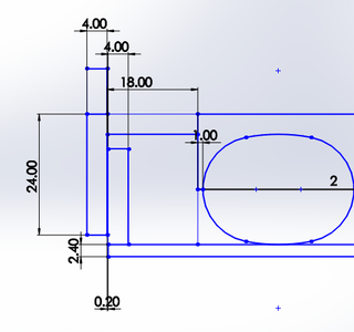

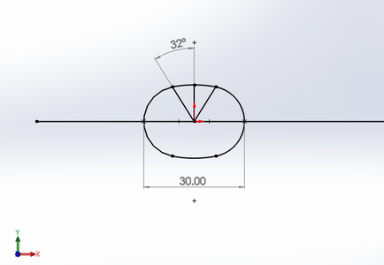

Step 1: Designing the Roller:making the Grooves

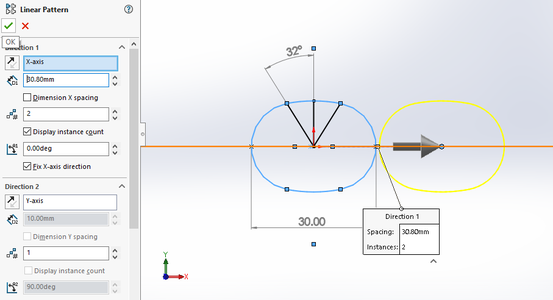

The first thing I needed to do was decide on the size and profile of the grooves that shape the dough into beans. I decided against using a simple eliptical contour to have more control of the shape and get a more bean-like appeareance. Also I went for a 3cm cookie for a 1-2 bite cookie.
The idea was for the bean to be a decent so it could be served as a single serving alongside a small cup of espresso.
I then repeated the contour several times leaving a 0.8 space in between to make 3d printable cutting edge.

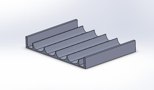

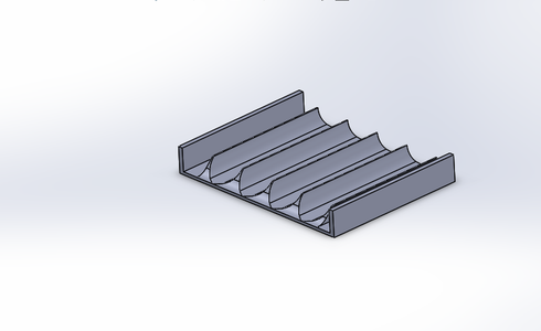

Step 2: Adding the Side Walls for Alignment
The next thin was adding the side walls for containment. They help to keep the top and bottom grooves aligned while rolling. The depth is crucial. they need to be taller than the cutting edge to help with alignment before the grooves start cutting into the dough.

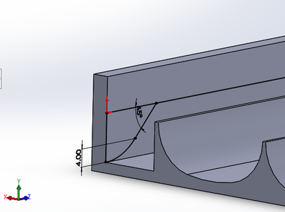

Step 3: Adding Bevels for Smoother Operation
After extruding, to help the dough cýlinder enter into the grooved section, I added bevels to both parts of the roller.

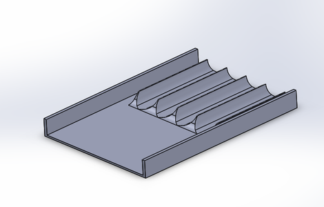

Step 4: Adding the Flat Side
I then incorporated a flat area adjacent to the grooved section, this is where the dough is shaped into a cylinder before getting divided.

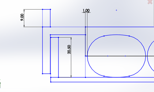

Step 5: Fine-tuning the Side Wall Height
After that it was a matter of testing the prototype to find the ideal side wall for the bottom part. This is crucial because it helps forming the dough into the right diameter for the rolling process.
Rolling the dough using the flat side of the top roller you can reduce the section until contact is made with the side wall, meaning the right measurement has been reached.
I found 20.5mm to be a good value, but it might ttake some more testing to get to the swet spot.
