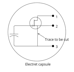

The first step was to take apart one of the capsules in order to have an idea on how this particular capsule works. Opening it up revealed a capacitor consisting of a movable plate and a fixed plate. The movable plate or diaphragm was attached to the aluminium casing. The fixed plate was attached to the gate of a JFET used as a common-source amplifier along with an externally attached source resistor. The FET amplifier provides an amplitude gain of three with the recommended source resistor. This condenser capsule is exactly the same in design as the Panasonic capsule Linkwitz used and is the reason for basing this microphone on his plans.
The movable plate of the capacitor is connected to the source of the JFET through a pcb trace. This trace is cut and replaced by a source resistor in order to turn the source amplifier in to a source follower. This is done as a source follower offers better linearity than a source amplifier and hence reduces distortion.
