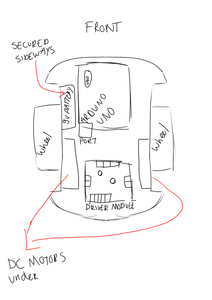

For this step, you will assemble the circuits you have prepared so far to fit the round car kit. Start by following this tutorial to assemble the first part of the car, but do not add the second layer yet. On the first layer, secure your Arduino, driver module, and 9V battery. I made a sketch to illustrate the positioning of these components.
Once you have completed that, you can proceed with the tutorial. To connect the Arduino Uno with the ultrasonic sensor, you can route the wires through the long openings on the front side of the car. Refer to the pictures for an example of how this can be done.
