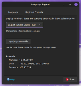

Exactly how to set your locale will probably depend on your specific distribution. I'm using Ubuntu-MATE 21.10, so I can find the language settings in Menu > Preferences > Language Support. Under Regional Formats, I can select my custom locale as the default under "Display numbers, dates, and currency amounts in the usual format for:" and selecting English (United States) - ISO. I can click Apply System-Wide to make it the default for everywhere, and not just for my user.
Logout and log back in, and hopefully your locale should be working! You can check by running the locale command, and the output should look something like this:
