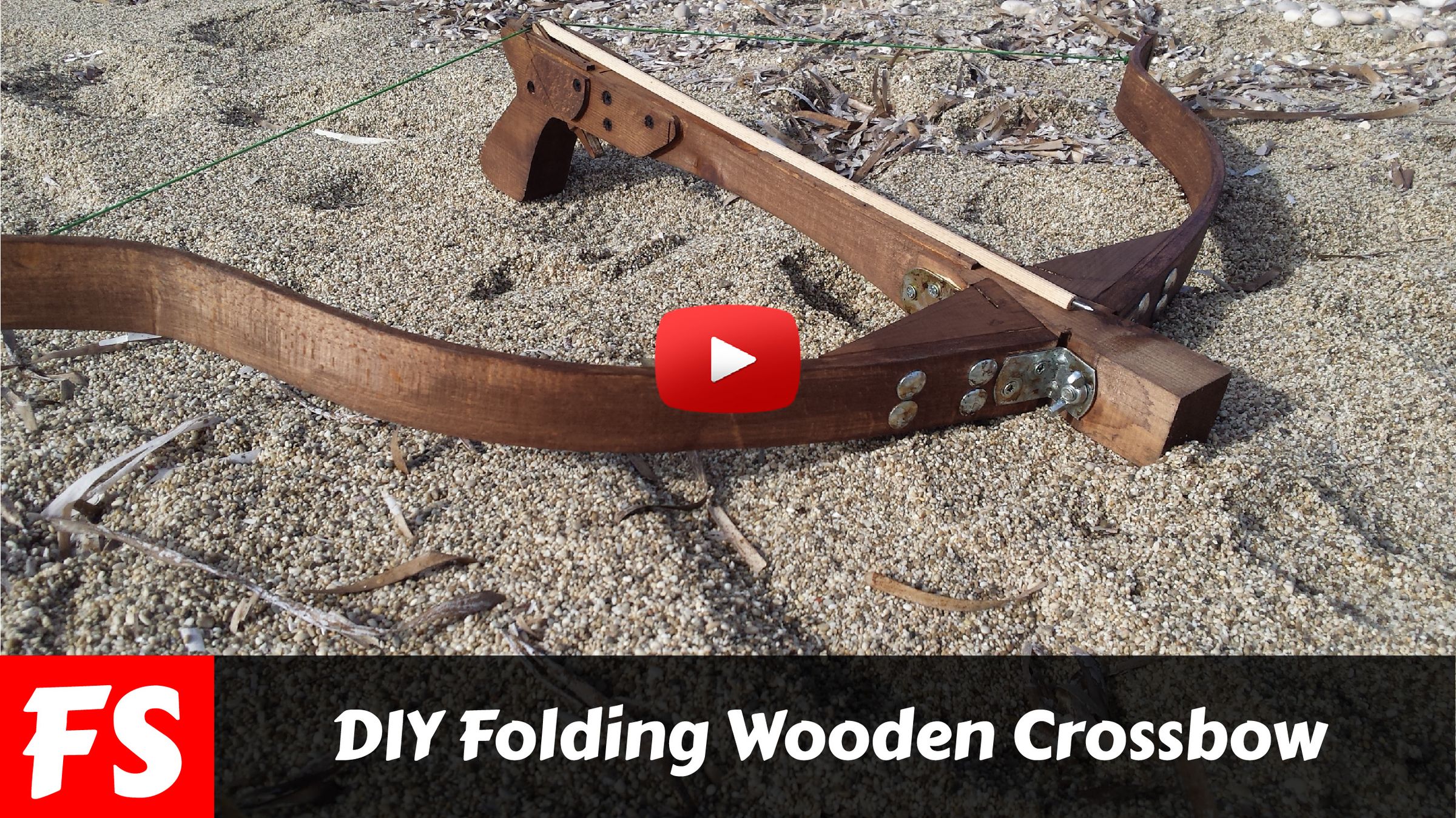

I have always wanted to make a crossbow but never had the time to do it. Finally last week I took a few days off work so I made one.Here I am going to demonstrate the process of making it.
Here is a video showing how I made it step by step:
And the plans:
