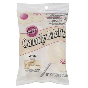

- 1 bag of off white candy melt (Again, Amazon.com or just about any craft or fabric store)

I picked up a bag of off white Wilton’s Candy Melts from Michael’s for about $2.00 (I had a coupon for 40% off. Free on the app. Get the app…it’s so worth it!).
Put your candy melts into a microwave safe bowl and zap them for about 15-30 seconds at a time, stopping to stir them between each zap until they're fully melted and smooth. Don't over zap!
Spray a quick shot of your cooking spray into your clean and dry mold, making sure to get all the nooks and crannies.
Pour your melted candy melts into your skull and and slosh them around by tilting the mold until the entire interior is fairly evenly coated. As the candy melts cool, you can use a clean spatula (NOT YOUR SILICONE MIXING SPATULA..KISS THAT ONE GOODBYE FOR FOOD PURPOSES) to help push the candy into areas where it might not be going easily.
Once you are satisfied with the candy coating, tuck the mold into the freezer and wait about 10 minutes.
Once the candy again solidifies, it should easily popped out of the mold…leaving you with a perfect 1:1 scale fully edible candy melt white chocolate skull!
