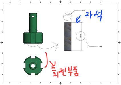

Step 2: Problems Making Rotor Magnet Grooves
To turn an (induction) motor into a generator, a permanent magnet must be installed on the rotor. The surface of the rotor must be cut to a size suitable for the magnet.
Making the groove was the problem. At first, I thought about cutting it with a grinder, but it was a hassle.
Step 3: Redesigning the Rotor
So, I designed a new rotor part and tried to print it out with a 3D printer.
As a result, another problem arose.

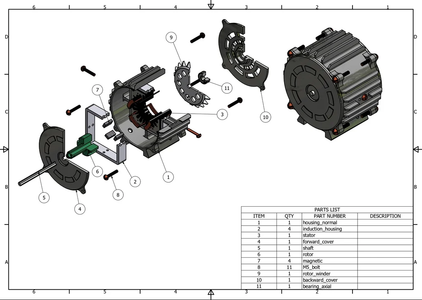

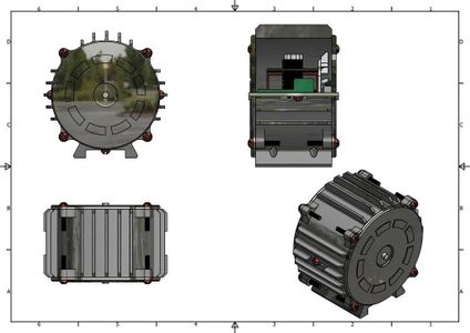

Step 4: Redesigning the Motor Case
Even the size of the fan motor case had to be taken into consideration.
In the end, I decided to redesign the case and print it with a 3D printer.
Step 5: Each Part Is Made With a 3D Printer Print
The designed parts were printed using a 3D printer.
Attach the fan motor stator to the parts printed on a 3D printer.
I secured it with a cable tie.
I also fastened the wires with cable ties and gathered them all together.

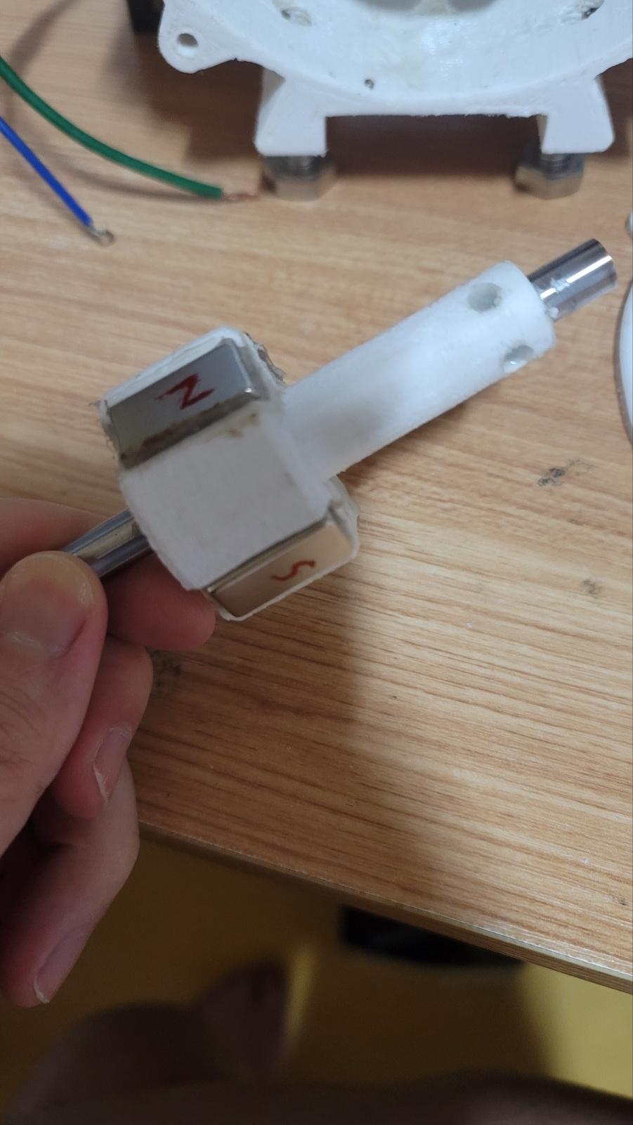

Step 6: Attaching Magnets to the Rotor
Align the magnet with the rotor insertion groove and apply adhesive to attach it.
Step 7: Mounting the Rotor and Stator to the Case
Attach the stator to the case printed on the printer.
I pulled out the wire separately into the hole on the left side of the case.
Then attach the magnet to the rotor pulled out by the printer with a glue gun.
It was mounted so that it was centered on the stator.
The stator was fastened on both sides with M5 bolts.

Step 9: Attaching the Case Cover
Install the back case cover part by tightening it with M5 bolts.
Install the Keas front cover by tightening it with M5 bolts.
Step 10: Assembly Completed
This completes assembly.
