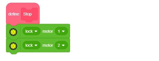

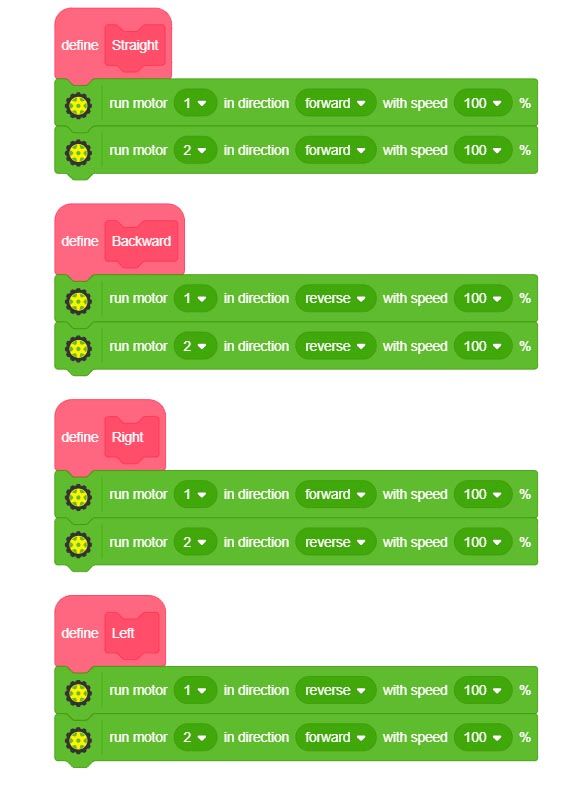

Step 5: Code
PictoBlox is a graphical programming software based on Scratch 3.0 that makes learning how to code easy and fun. It allows you to interface and control evive with your computer and even uploads code to it.
You can download PictoBlox from here.
Upload the following script to evive:

When we tilt the phone either forward or backward, acceleration along the X-axis changes. If the acceleration along X-axis goes above 3 m/s2, then the robot will move in the forward direction. If it goes below -3 m/s2, then the robot moves in the backward direction.
If we tilt the phone either left or right, acceleration along the Y-axis changes. If the acceleration along Y-axis goes above 3 m/s2, then the robot moves in the left direction. If goes below -3 m/s2, then the robot will move in the right direction.
If the acceleration along both the axes i.e X-axis and the Y-axis is between -3 m/s2 and 3 m/s2, then robot does not move.
