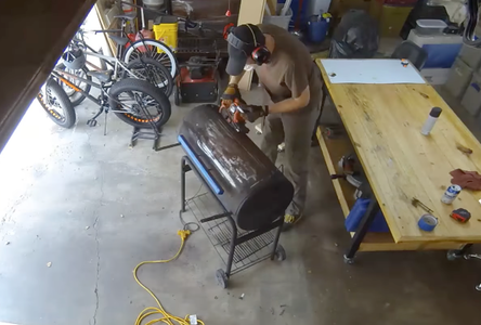

Nobody likes dirty junk. It smells funny, makes your hands gross and is generally unappealing in many ways. Ladies and gentleman, let's all clean our junk.
Once all the crud was cleaned out, I belt sanded the loose rust and did general cleaning of the entire grill. I painted the entire thing with high-temperature paint.

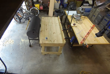

Make a box-like object that resembles a tall desk or a workstation.
Step 3: Now Cut a Hole in That Box

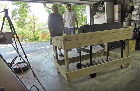

Step 4: Now Stick Your Grill in Dat Booooox

I definitely didn't want the old grill cart under my fancy new setup so I drilled lag bolts through the grill into the pressure treated wood. I added a bunch of washers that will hopefully act as buffers and keep the entire thing from turning into a giant lump of coal on wheels. Once the grill was mounted I pulled the old cart out of the bottom.

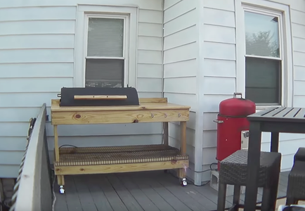

Step 12: Bask in My Accomplishment
The entire thing cost just as much as buying a new shiny grill, but that's not my style. I wanted this to fit into a specific space and to have a few upgrades so it all worked out for the best.
I now store charcoal and a chimney starter and the usual grill type stuff in the bottom for easy access.
