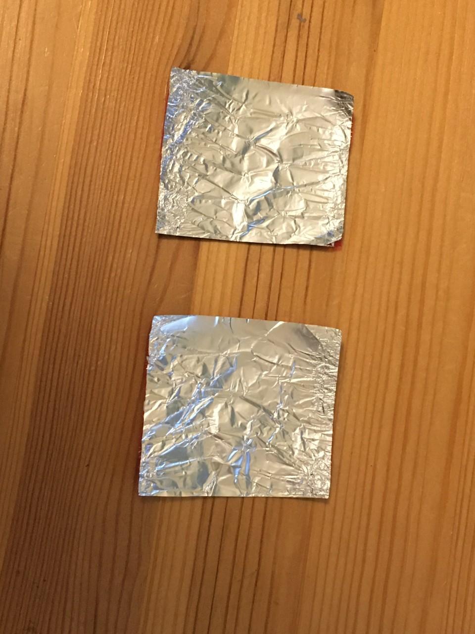

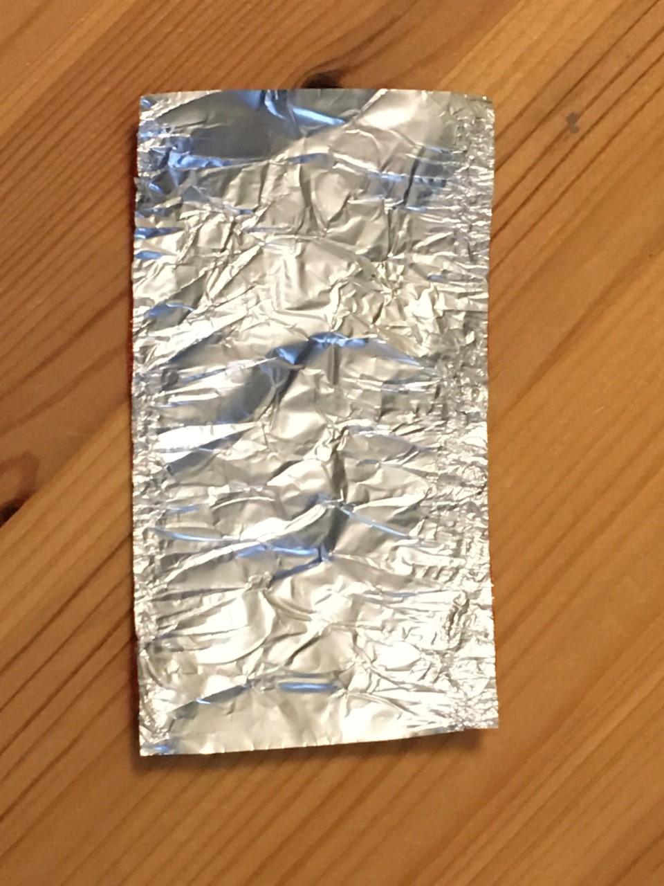

Step 1: Cut Your Wrapper/foil
Cut your wrapper down to about 50 by 90 mm then, cut that rectangle in half so you end up with 2 almost-square shapes.

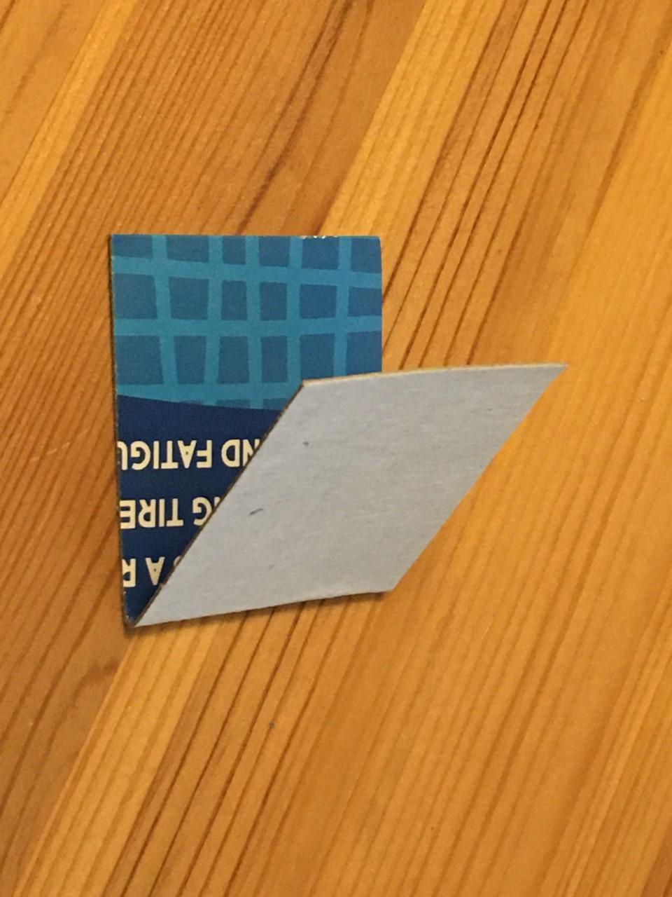

Step 2: Cut and Fold Your Cardboard
Simply cut a rectangle of cardboard from a cereal box, then fold it in half as shown above. Crease it hard but let it spring back.

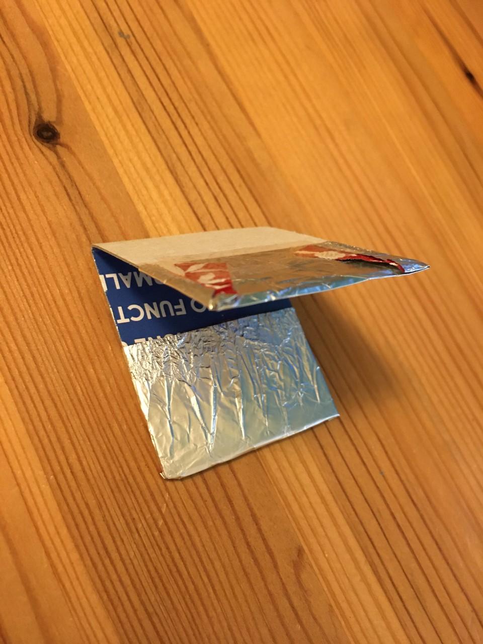

Step 3: Construct Switch Main Body
Fold the foil over the edges of cardboard and apply a small amount of tape to the outside. If you put the tape on the inside, the metal parts won`t meet up because there will be plastic in the way.

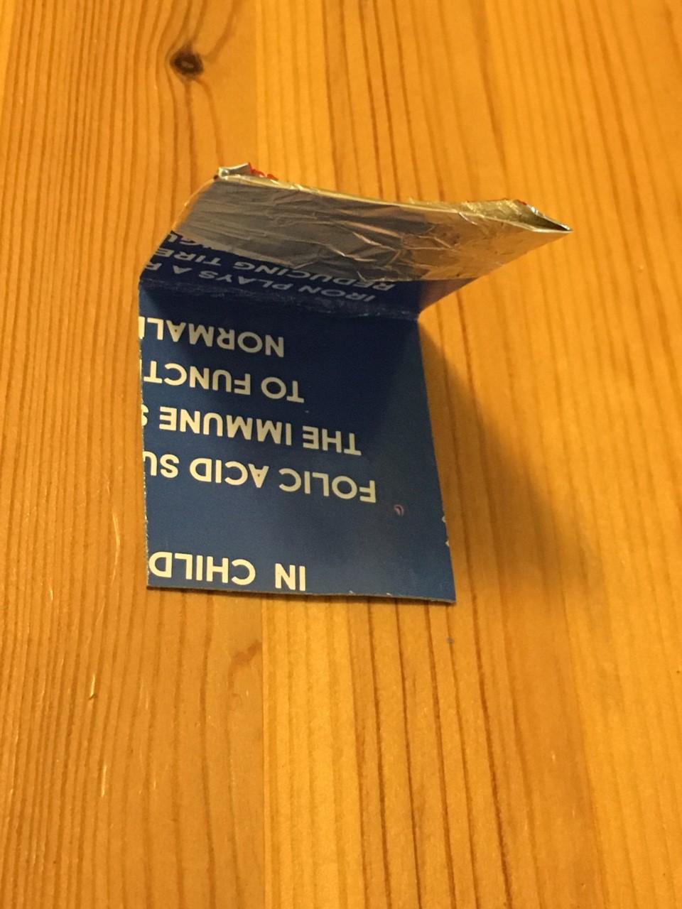

Step 4: Use
To use the switch, add wires to the outside of both tin foil sections as you would for a normal switch. Then, when it is wired into a circuit, push down the top of the switch so the metal ends touch. The circuit will then work.
