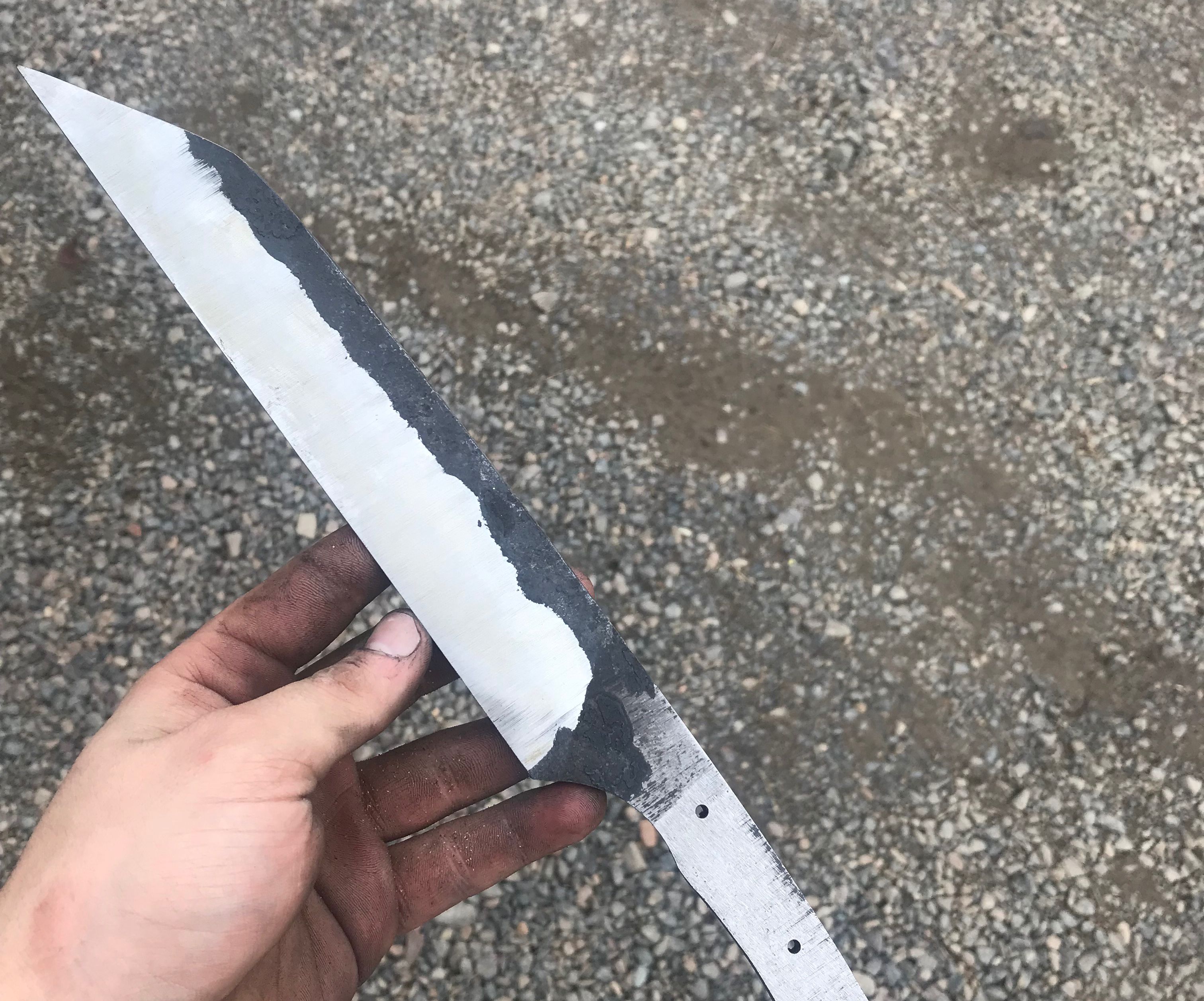

Step 1: Gather Your Steel and Draw the Design
Find a scrap pice of steel you can draw a knife on and then draw in sharpie on the steel what knife design you want to make
Step 2: Cut Your Knife to Shape
I used a 4.5 angle grinder to cut a rough shape then used my 2x72 belt grinder to finalize the shape any belt grinder would work
Step 3: Mark Your Holes and Bevel
I used blue dikem and then marked the holes I will drill and the line I will grind the bevel to
Step 4: Rough Grind the Bevels and Then Go Up in Grit
I start with a new 60 grit belt then go up to 220 grind the bevel and flats use a magnet to hold the knife
Step 5: Heat Treat
Heat up the blade until it is orange to yellow hot and quench in oil till it is cool to touch then temper in the forge that is still warm and let cool to air temp
Step 6: Handle Prep
Cut a pice of wood to the size of your knife handle and drill pin holes in the wood make sure they line up then grind the handle to shape and epoxy the handle scales to the handle
Step 7: Finish Handle and Sharpen
Shape the handle and then hand sand buff until it’s to your liking then sharpen the knife and you are finished nice job
