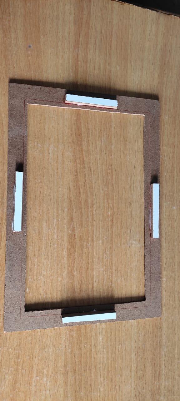

Step 3: Making the Display Frame
For making the display frame, cut out a 22cm x 13.9cm rectangular sheet from the front sheet as shown in the pictures and fix the 4 supporter with the help of glue so that display could not move.
