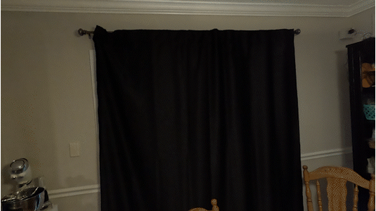

And now for the finale - actual installation! I wanted the pulley in a specific location, so I mounted it first. Next, the binder clip needs secured behind the curtains such that it will be concealed from view and can easily pull the curtains back and forth. Next, pull the motor housing such that the line is as tight as possible and secure it against the wall. Last, plug in the electronics and... that's it! You have Smart Curtains that can use voice commands, open for sunrise, close at sunset, and can easily handle additional capabilities. Take it for a whirl if you're so inclined, and then we'll jump right into those additional capabilities.

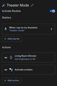

Step 6: Theater Mode
This is a little bonus, because why not. If we already have smart curtains, we may as well use that to our advantage to set the stage for an ideal movie watching experience.
You may have already noticed in the code that there's a second call we're listening for from Adafruit. This is used to strictly close the blinds. As that implies, you'll need to get this setup on IFTTT and Adafruit IO, but this all uses identical logic to what we did the first time with just a different feed name and command. There's a little trick to getting this all to cooperate, but once you know it it's easy and everything is included here.
Start off as you normally would and add a new Routine in your Google Home app. Add your activation command, but be sure that it's something different from what you say to activate the IFTTT applet. For example I setup my Google Home routine to activate on "Theater Mode", whereas the IFTTT applet trigger is "Activate Close Blinds". Include any actions that you feel like including, like dimming the lights. Then, add a custom command as an action. In this, write what you would say to activate your IFTTT applet. Doing this will correctly initiate the applet, inform the Adafruit IO feed, and make it to your ESP8266 all as it would with a normal voice command.
And with that, you're good to go and can easily add whatever bonus features you want for Theater Mode (or whatever you end up coming up with) as well! I'll be curious what other features people come up with. I know I'm a little more than tempted to try to figure out how to automatically get popcorn going...
