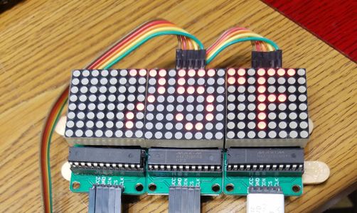

With this in mind I decided to build an on-board train display using three 8x32 LED boards. Each board is mounted on a car with the three connected together to create one long scrolling message board. To make things even more interesting and compelling to visitors the display's message can be changed remotely with a cell phone or computer. My first set of modules were mounted on three small G-scale ore cars. My latest G-scale installation has two modules on each of two box cars. To make it visible from any angle the display is duplicated on the back of the box cars. This facilitates viewing no matter where the cars are on the layout. A total of eight 8x32 modules are on the two box cars.
Step 4: The Display Modules
The display units are available from Amazon and other vendors. Each is made up of four 8x8 display modules combined on a single circuit board. That makes connections very easy.
Step 5: Display Connections
The display has a 5 pin input header on its right side and a 5 pin output header on the left. The Arduino is connected to the right side (as viewed from the front) and additional modules are connected to the left. The connections are
VCC - positive 5 volts
GND - ground DIN - data in - Arduino pin # 11
CS - chip select - Arduino Pin # 10
CLK - clock - Arduino pin # 13
Step 6: Dim Displays
The displays are not as bright as they could be as they are delivered. In order to increase the contrast I always cover such displays with transparent red acrylic or red plastic tape. To keep the size and weight down I opted for plastic tape for this installation. I purchased it from eBay.

Just about any of the Arduino variants should work. I chose to use the Pro Mini and the Nano for my two projects as they are much smaller than the UNO and many of its brothers. This schematic shows the Pro Mini - wiring for the Nano is the same except for the location of some of the pins.
Step 10: The Software
Three libraries need to be installed. They are
MD_MAX72xx - https://github.com/MajicDesigns/MD_MAX72XX
MD_Parola - https://github.com/MajicDesigns/MD_MAX72XX
MD_KeySwitch - https://github.com/MajicDesigns/MD_MAX72XX (note - The KeySwitch library is left over from the Scroll example and is not needed. I left it there as some residual code that I modified does not compile unless it is there. )
The Arduino sketch that I put together is composed of code from a number of sources including an example, Parola Scrolling, from the MD_Parola library. This library allows you to select the orientation of the modules and works very well with the 4 module boards.
In order to configure the library for these boards you must edit one line in the https://github.com/MajicDesigns/MD_MAX72XX library. The file that must be edited is called MD_MAX72xx.h
On my Windows computer I found this library in the following directory.
users/dave/documents/arduino/libraries/MD_MAX72xx-master
You may find it in another folder.
When you find the file change the line that reads
#define USE_FC16_HW 0
to
#define USE_FC16_HW 1 Save the file and restart the Arduino IDE.
