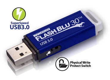

Any USB drive will do but I prefer the 3.0 type for faster access. The 3.1 type is rare right now but in the future I will get a few. There are flash drives with a write protect switch and I highly recommend these as an all-in-one rescue USB drive (you don't want viruses crossing over). The capacity can be as large as financially reasonable (I use a 32Gb).
