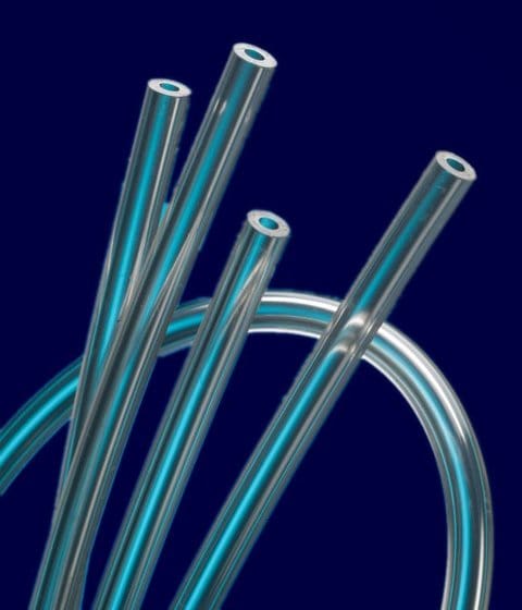

10. plastic tubing correctly sized for your design
11. flat-tipped needle of appropriate gauge for tubing outer diameter (to punch holes)

Prepare holes for inlets to the device. A dedicated microfluidics puncher may be used. A low-cost alternative is punching holes through the PDMS replica at the inlet and outlet locations using a blunt, flat-tipped needle and discarding the punched out PDMS. Select the needle gauge for the appropriate tubing you plan to insert. For instance, a 17 gauge needle has an outer diameter of 1.473 mm, which should fit with 1/16" or 1.58 mm outer diameter (OD) tubing. If there is dust or dirt on the PDMS, it may be removed with Scotch tape. It is recommended that steps 4, 5, and 6 be performed in quick sussession to minimize dirt buildup on the device before it is sealed up. Avoid touching the replica surface.

Step 7: Insert Tubing and Operate
Insert tubing into the inlets and outlets of the device and hook up to any necessary external equipment. The picture below shows a simple microfluidic channel with two colored liquids being mixed.
