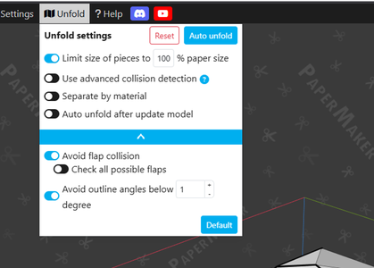

Click the unfold button in papermaker, this will create an unfolded version on the right hand side of the screen. On this side you can move and adjust the unfolded pieces to fit them best onto the pages
