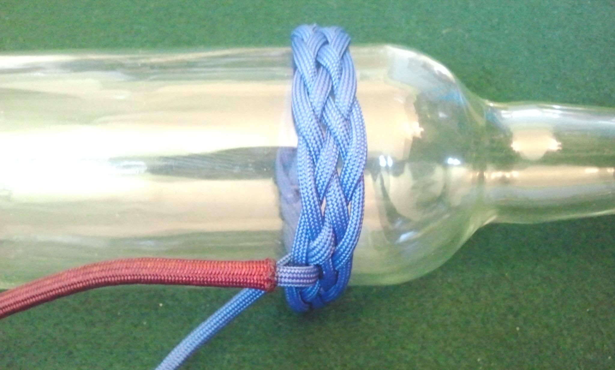

Step 20: Bracelet Pattern
Each successive blue strand goes under the next black strand and gets pulled up tight.
