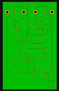

Step 1: Making Power Amplifier PCB
To make the power amplifier circuit, I am using only bipolar junction transistors. There are total eight transistors in power amplifier circuit. Q1 and Q2 are attached on heatsink because they are power transistors and gets hot during use. Q1 and Q2 both are npn transistors. Transistors Q3 and Q4 is used to the Q1 and Q2 transistors respectively. Transistor Q6 is used as Vbe multiplier to bias the base of transistors Q3 and Q4. It is necessary to properly bias the base of Q3 and Q4 otherwise amplified signal will be distorted(crossover distortion will occur). Transistors Q3 and Q4 are operated in class AB mode. Q5 is a class driver transistor to drive the output stage or push-pull stage of the power amplifier. The base of Q5 is connected to the output of differential amplifier. Transistors Q7 and Q8 forms a differential amplifier stage. Q8 and Q7 are pnp transistors. Input signal is applied to the base of transistor Q8 and feedback signal is applied to the base of transistor Q7. The voltage gain of the power amplifier can be calculated by the following expression:
Voltage gain = {1+(R11/R12)}
R11 = 15K ohm, R12 = 150 ohm
hence,
Voltage gain = {1+(15000/150)}
                  = 1+100
                  = 101
The power amplifier circuit requires floating ground dc power supply of 18V. Maximum output power of the power amplifier is 34.4 Watts
Pout(Max.) = 34.4 Watts.
