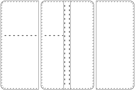

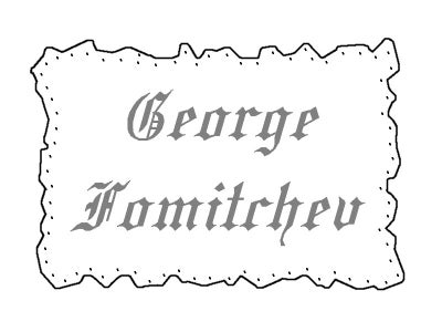

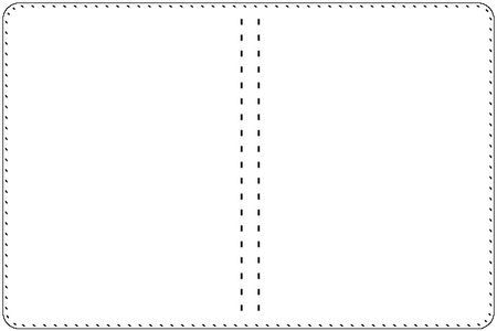

In the graphic editor, a vector image of the cover, internal elements and appliqué is created. The image shows the cutting edge and hole locations for further sewing.

Cutting for each pattern is carried out on a separate sheet of leather. The inscription on the appliqué was carried out in the same mode, but a light shade of gray was set in the graphics editor. Thus, these areas were not cut, but engraved to a depth of 0.5 mm. Since the leather smokes during processing, a blower or a smoke extractor should be used.For processing, a sufficiently powerful Endurance 10 Watt DPSS Laser was used (link to the installation: https://endurancelasers.com/an-endurance-brand-new-fiber-marking-module-for-metal-engraving/)

After receiving the finished cover parts, they should be sewn together. The seams were manually sewn with 0.2 mm thread. All parts are the same size and hole ratio.
