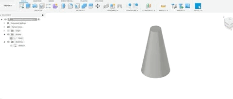

Step 1: Creating the Main Shape
To begin making your impossible passthrough, you will want to make the main shape of the fidget. If you look above I have created a gif for you to try to follow along. I created a sketch of a circle then I used the extrude tool to turn it 3d and used the taper angle to create a cone shape.

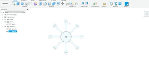

Step 2: Create the Twist Pattern
This second step will teach you how to make the twist pattern for the passthrough and if you look above I have provided yet another gif (I hope these are helpful). In this step you would want to make another sketch and you see above I have created a simple pattern using circles and rectangles and teaching you how to use the mirror tool and the circular pattern tool. For my passthrough I created eight things coming from the center. I would like to add that other patterns can work to but this is the easiest.

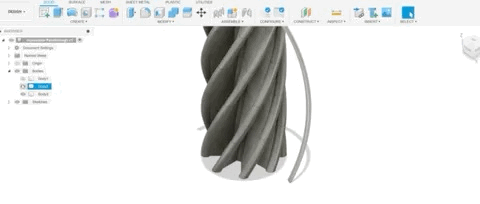

Step 3: Creating the Twist
This third step will teach you how to make the “Twist” for the passthrough. If you don’t understand what the “Twist” is, let me explain. The passthrough consists of two pieces and when the one goes into the other, well it twists (You can see this in the gif of the supplies section). To create the twist, you begin with creating a coil but with less than one full revolutions and with a height taller than your main shape (see step 1). Then you will use the sweep tool (path+guide surface) and you will use the twist pattern and the coil to create the “Twist”.
Step 4: Almost There!
This is the last step to designing the passthrough. You will need to duplicate the “Twist” and to do that you can just copy and paste. Then you will combine that with the main shape from step one and intersect the two to make a new component which will give you your first piece. You will then use the other “Twist” and subtract it (using the combine tool) and create another component which will be your second piece. After that you are done designing your passthrough!

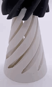

Step 5: 3d Print It
When you have finished designing the passthrough, you can export it as an stl. and import it into your slicer. When you import it you may adjust the size to your liking and you will want to print each piece separately. However before you print it you will need to do one important thing to ensure that the one piece will slide smoothly through the other. If you look above I have two pictures (one is for Bambu Studio and the other for Prusa) with something highlighted. That will allow you to offset one of the pieces to go smoothly through the other. You will probably want to set that number to -0.3 for both pieces and that will make both pieces go smoothly past each other.When all is sudden done, you should have a passthrough fight to play with and it should work better the more you fidget with it.

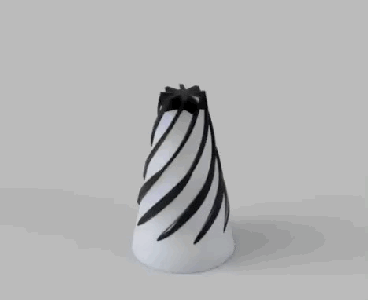

Step 6: Some Renders
Here are some of my renders that I have. If you have some renders that you would like to add to the collection please share down in the comments section. If you want guidance to rendering I will try to help you as much I can.
