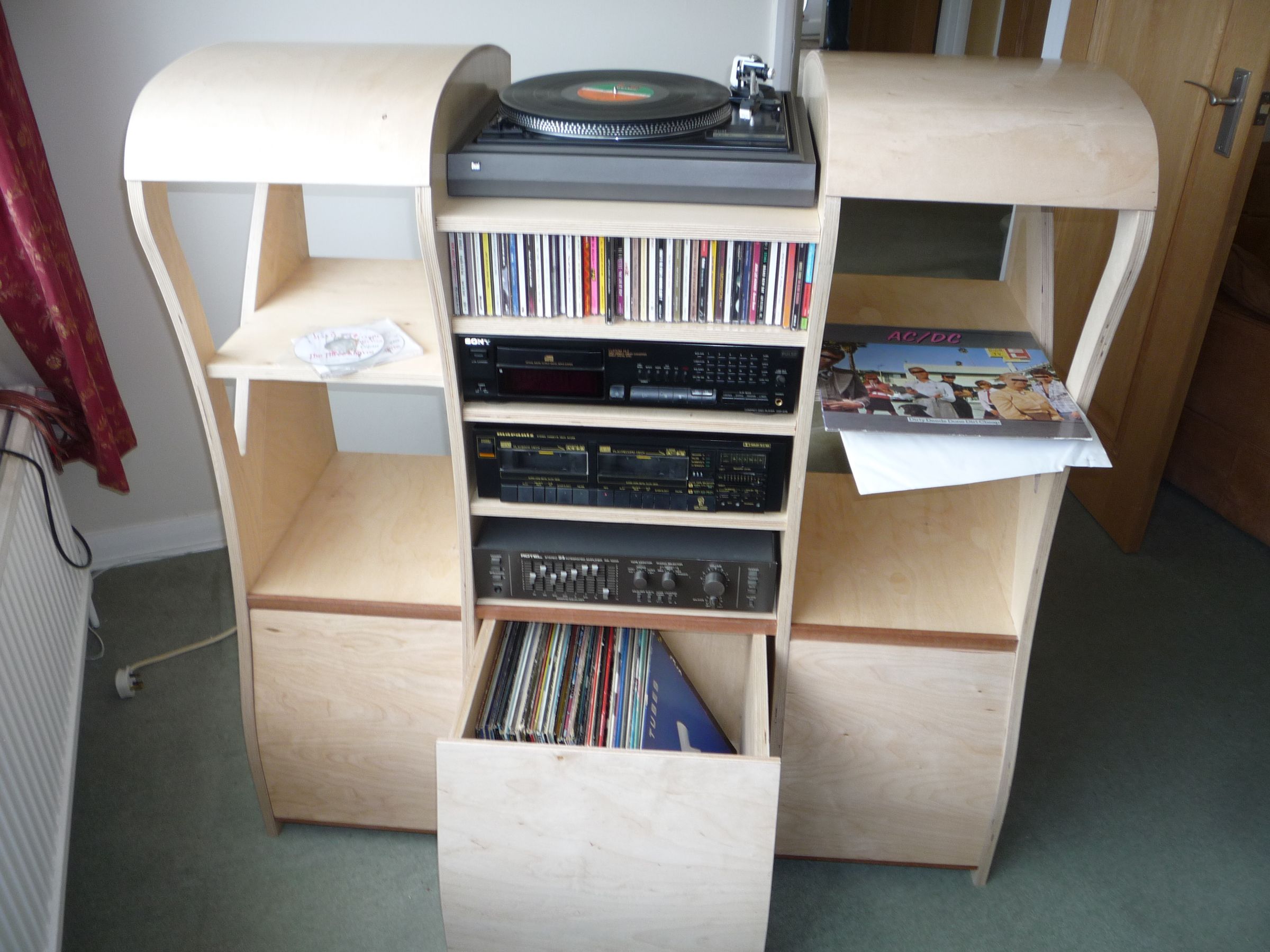

This is an instructable about the piece of furniture I made for my A Level design course. It took me the best part of 4 months with about 4 and a half hours a week. I think it came out well and my Dad (who i made it for) really likes it. It is made completely from birch plywood, except the hardwood (sapele) strips on the drawers and shelves.
It was designed to hold all of my Dad's records, some of his CD's and his sound system. Since then he has treated himself to a new record player and amp, to go with the furniture apparently! I think all of the wood I used came to about £150 - £175 definitely no more than that.

Step 4: Manufacture 2 - Curved Tops
This was the most technically challenging piece of the build as I had to decide how to manufacture the curved wooden tops and drawer fronts which give the piece its characteristic look. In the end I decided to use a vacuum forming technique, whereby several thin veneers are layered on top of each other with resin in between each sheet. Then the whole piece is placed on a mould in an airtight bag, the air is sucked out and the wood is formed to the contours of the mould.
I cut the mould out on the CNC machine and then bolted the whole lot together. This was then aligned and sanded to give a very even surface to reduce deformities in the moulding process.
The layers are then placed in the mould after being glued together with a resin which doesn't rely on air to go off, due it it being in a vacuum bag. The vacuum is turned on and then left for 24hrs for the resin to set.
The next day I took it out of the bag, peeled the newspaper off it and set about sanding and squaring off the piece, (which was made deliberately bigger than necessary) to fit it to the frame.
Once I was satisfied with the dry fit, I glued and clamped it into place before finishing it all off.

Step 5: Problem!
It turned out that for some reason either me, or the computer, had forgotten to cut out a whole shelf for the piece (personally I like to blame the computer). Obviously I only realised this after I had glued the main frame together(!) and this meant I had to think of a cunning way to retrofit on a whole shelf...
In the end I decided to cut out wedges out of the sides of the shelf and screwed the corresponding wedges onto the sides of the frame where the shelf would have normally sat. Then I just glued the shelf onto the wedges and put something heavy on it to help it stay in place.
Panic over!

Step 6: The Finish
For my project I chose to use a clear satin varnish to really show off the grain and colour of the wood that I had used. To apply it I used a variety of paint pads and fine high quality synthetic brushes, and I must have put on about four coats all In all.
I sanded it in between every coat going up to very fine 1200 grade wet and dry paper to get a really nice finsh. I put less coats on the undersides of the shelves but had at least 3 to properly seal the wood and make it durable.
Then to get a really nice shine on the tops, I actually ended up using car polish to buff it up and it gave it a really smooth, shiny surface bringing out the wood grain.
Once I had varnished it all I put the drawers back on and the piece was finished!
As I said my Dad really liked the piece and it is still going strong in the front room!
The finsished piece weighs a ton especially with all the gear on it as it is pretty much all solid 18mm ply!
Improvements:
If I wewre to improve it in some ways I think I would add more supports between the units, which would make the piece a lot sturdier when you moved it, but apart from that I was pretty happy!
