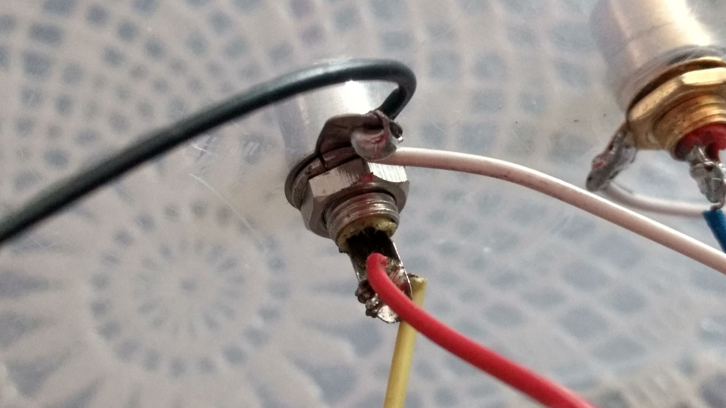

To connect the video we will need one 1k ohm Resistor and one 470 ohm Resistor, We will also need the yellow Composite plug.
Image taken from Here
So the pin sticking out of the bottom of the RCA connector will go to GND on the Arduino. Then get the 1k Resistor and connect it to D7 on the Arduino, Then after you do that get the 470 ohm Resistor and connect it to D9 then connect both of the Resistor's to the back of the RCA Connector. Also if you live where your tv stranded is PAL connect a wire from ground that is next to D13 and and then connect that wire to D12
Example here from fritzing
Close up of the video connector

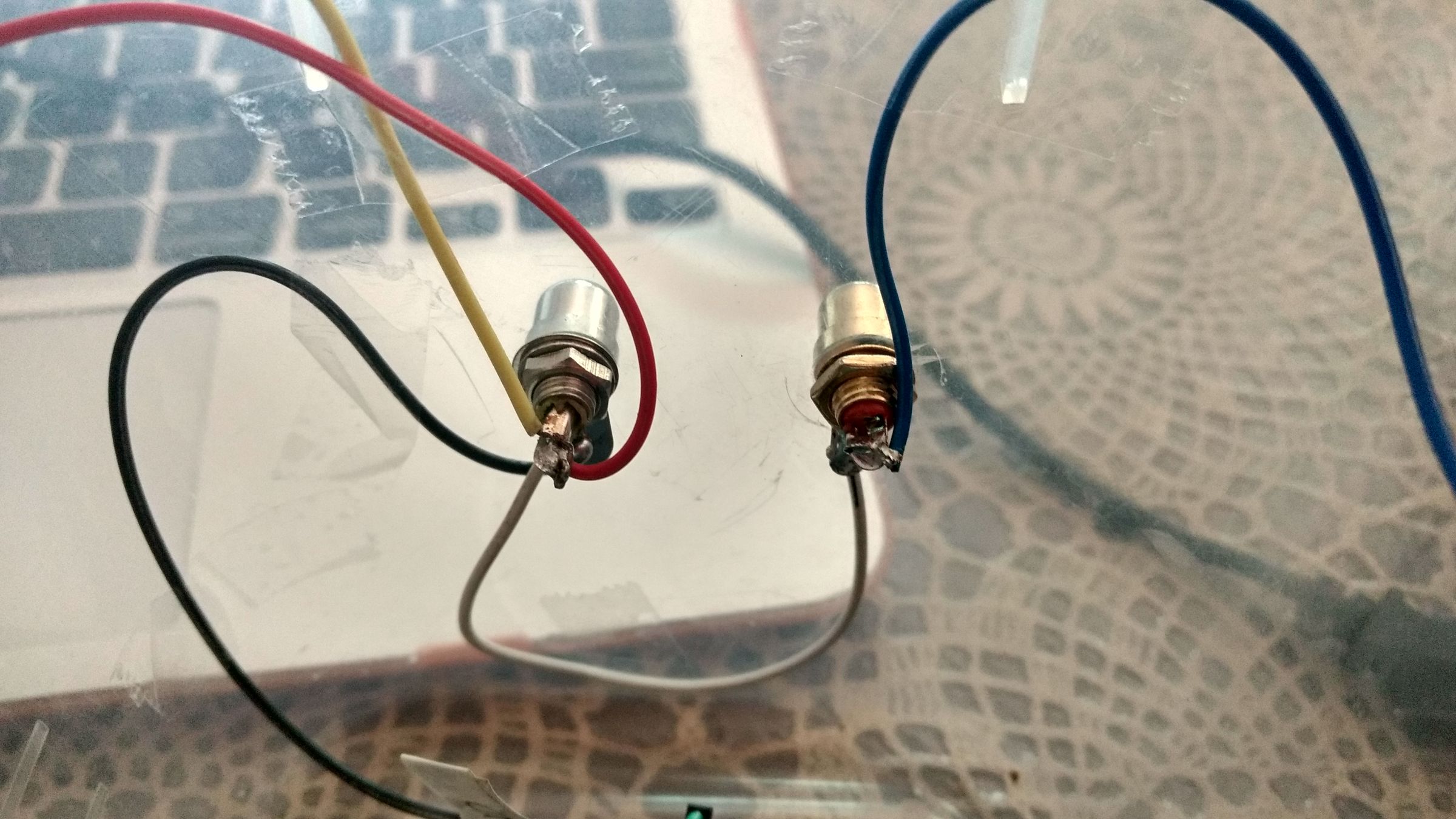

Audio
To Connect the Audio all we need is that last 470 ohm resistor we will connect that to D11 and the other side to the back of the other RCA Connector, Then connect a wire from the ground of the video plug to the ground of the audio plug
Both the video and audio connected to the Arduino (Video on left, Audio on right)

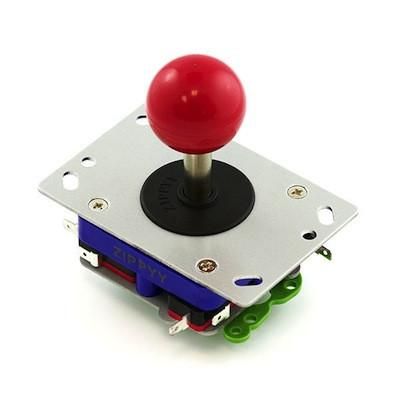

You can use eider a joystick like this
image taken from [Here]
or you can use four push button's
if you were using four push buttons just run a wire from GND on the Fire pushbutton to all the GND connector on the buttons then, connect the
Up button to D4
Down button to D5
Left button to D3
Right button to D2
and if you are using a joystick you will see three pins with every button, the pin on a Ange is the GND pin run a wire from the push button to each of the pins. then on the pin closest to it, is a on pin that is activated when the joystick is pressed. Also the buttons are opposite so if you push the joystick to the left it will press the right button.
