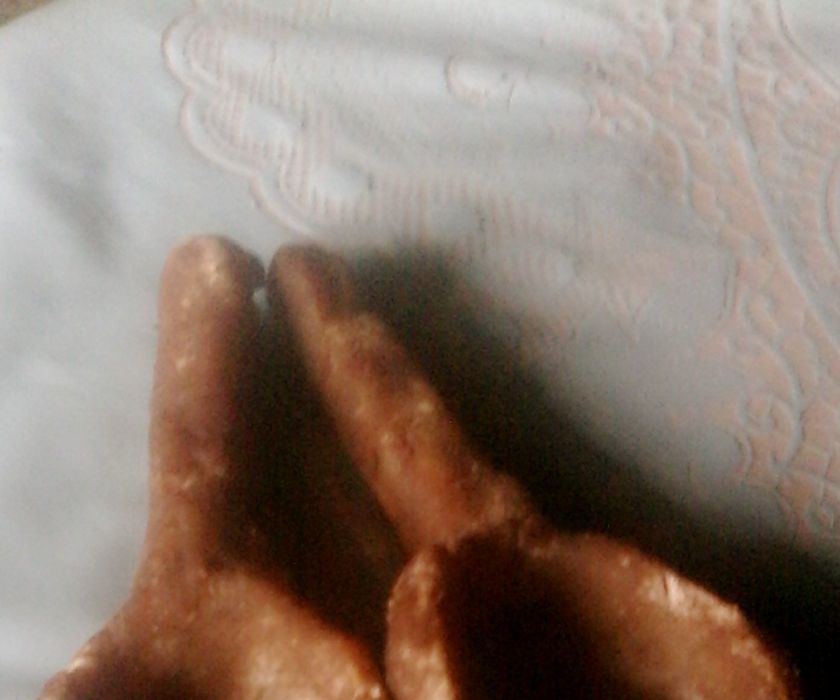

Step 4: Cover and Sew.
Cut out some of the white fabric. It need not be same dimensions as the black fabric. It will still be fine if it's smaller and just enough to cover the portion with the plastic bags. Get your needle and fishing line or thread or sewing machine and sew the materials together. Using fishing line is preferable over thread because it is stronger and almost invisible.
Purpose of white fabric: If heat ever permeates the black fabric layer and that of the plastic bag, this will reflect the heat back into the enclosure which in turn gives the heat back to the pot. Simple physics.
