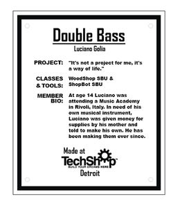

Step 1: Design Template
First step in the process was to make a template file on Illustrator.
I had many plaques to make, so making a template was crucial to keep
everything consistent. Every plaque has a title, member name, project
description, classes&tools, and the TechShop logo (with location of
projection's creation). And most, but not all, have member bio and
photography credits. It's a simple design, but to keep everything
organized, I made a series of guide lines to ensure even spacing.
Each member and their project has different amount of text, so I made
the design adjustable in height. Just scale the height to fit the
text using the guides.
