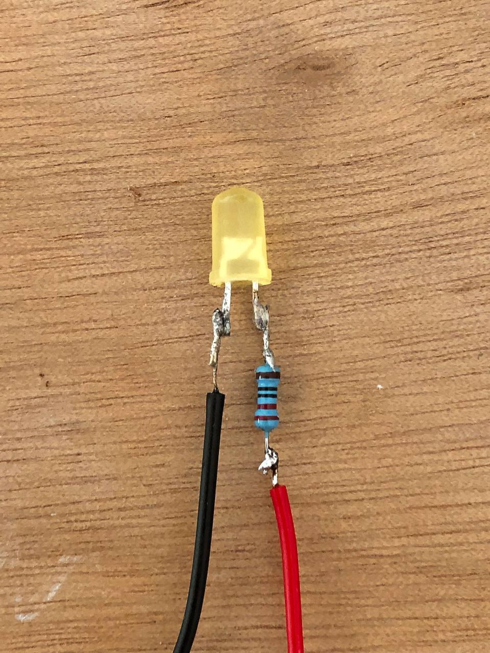

Step 4: Soldering the First LED
Now let's move on to soldering the first components. As you saw in the illustration, I want my LED's to be attached to different output pins, but have all their ground wire merged into one.
I soldered a 220Ω resistor directly to the anode of the LED, and proceeded to solder a red wire to the resistor as well.
Then I soldered a black wire to the cathode of the LED.
After that, I wanted to insulate the two exposed wires from each other to prevent a short-circuit. I used electrical tape, which does the job for small amounts of electricity like this.
In the end, you should have a working LED which you can plug into your Arduino!

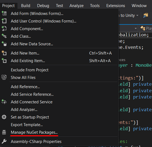

Step 15: Communicating With Unity
To communicate with Unity, I made a dedicated class to retrieving, and storing information sent through the serial port.
The class makes use of the System.Threading namespace, but more remarkable the System.IO.Ports namespace, which requires a bit of tinkering to make it work.

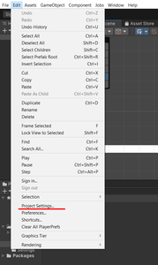

The System.IO.Ports namespace is not recgonized unless you install it's package in Visual Studio's built in package manager, or install it alternatively here: https://www.nuget.org/packages/System.IO.Ports/8.0.0-preview.7.23375.6.
On top of that, make sure that your Api Compatibility Level is set to .NET Framework, inside the Project Settings!
