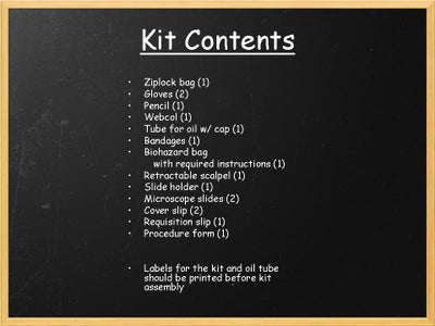

Step 1: Kit Contents
The following items are needed to assemble one scabies skin scraping kit.
Ziplock bag (1)
Gloves (2)
Pencil (1)
Webcol (1)
Tube for oil w/ cap (1)
Bandages (1)
Biohazard bag with required instructions (1)
Retractable scalpel (1)
Slide holder (1)
Microscope slides (2)
Cover slip (2)
Requisition slip (1)
Procedure form (1)
Ziplock bag (1)
Gloves (2)
Pencil (1)
Webcol (1)
Bandages (1)
Slide holder (1)
Cover slip (2)
Procedure form (1)
- Labels for the kit and oil tube should be printed before kit assembly

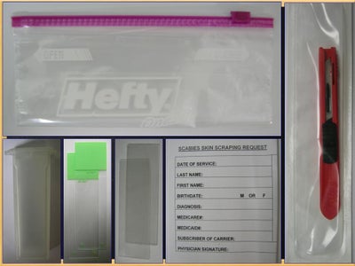

Step 5: Items Placed on Image Template
Here is an example of all kit items placed on the image template.
In order to expedite kit assembly, you can label and fill multiple oil tubes, and prepare slide holders (containing two slides and two cover slips) before-hand.
Assuming oil tubes and slide holders are prepared before-hand, a complete kit is composed of eleven (11) unique items, not counting labels.
1. Ziploc bag
2. Requisition Form
3. Procedure form
4. Pencil
5. Oil Tubes, labeled and filled
6. Prepared slide holder (containing two glass slides and two cover slips)
7. Bandage
8. Webcol (alcohol prep pad)
9. Safety scalpel
10. Two Gloves
11. Specimen Bag

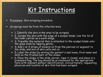

Step 6: Skin Scraping Procedure
This video shows the appropriate pressure to exert on skin when doing a skin scraping for scabies.
Note: Scrapings must be from the infected area.
1. Identify the skin in the area to be scraped (between skin folds, red lines, pencil point like dots).
2. Scrape the skin with the edge of a scalpel blade. Use the lid of the inner carrier as a work-stage.
3. Transfer the material that is attached to the scalpel blade onto the glass slide by tapping gently.
4. Add 1 or 2 drops of mineral oil from the pierced oil segment to the slide, and mix of skin cells and oil.
5. Label the slides by writing the patient's last name, first name and date on the frosted part of the slides.
6. Place the slides in the slide carrier, tape it closed, and place in a biohazard bag. The bag should be accompanied by the appropriate form with relevant patient identification, clinical history, requesting physician and location of skin that had been scraped.
