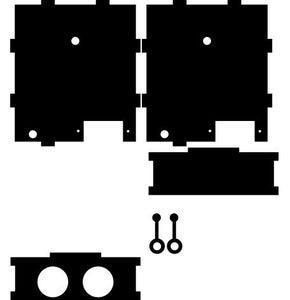

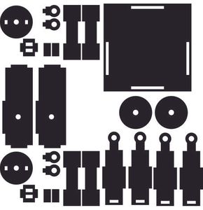

Drawing.
Software: Illustrator
Step 2:
Laser cutting.
