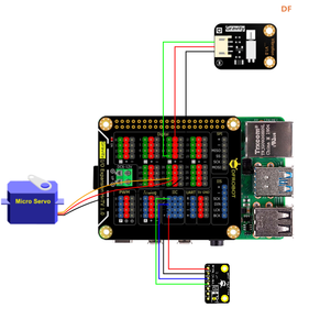

Step 1:
Step 2: Get Sensor Library
Power up the raspberry, and obtain the BMX160 library through the following command.
   git clone  https://github.com/DFRobot/DFRobot_BMX160
This library includes Arduino and Python, only the later part will be used.

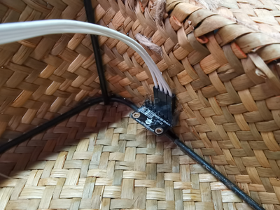

Step 5: Fix the Sensor
Fix the BMX160 sensor to the one corner of the box, pay attention the direction.

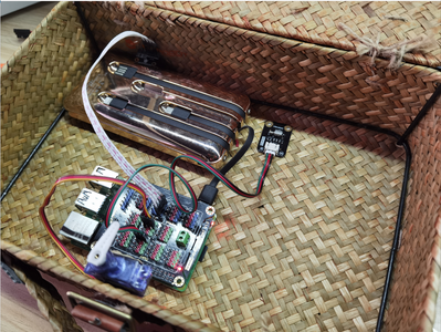

Step 6: Install and Connect
1. Fix the servo to the side of the box, make it near the box switch. The servo will be the lock of the box.
2. Attach the vibration motor to the bottom of the box. It aims to get feedback every time one password is completed.
3. Fix the Raspberry Pi and 5V power inside the box, wire up all parts together.
