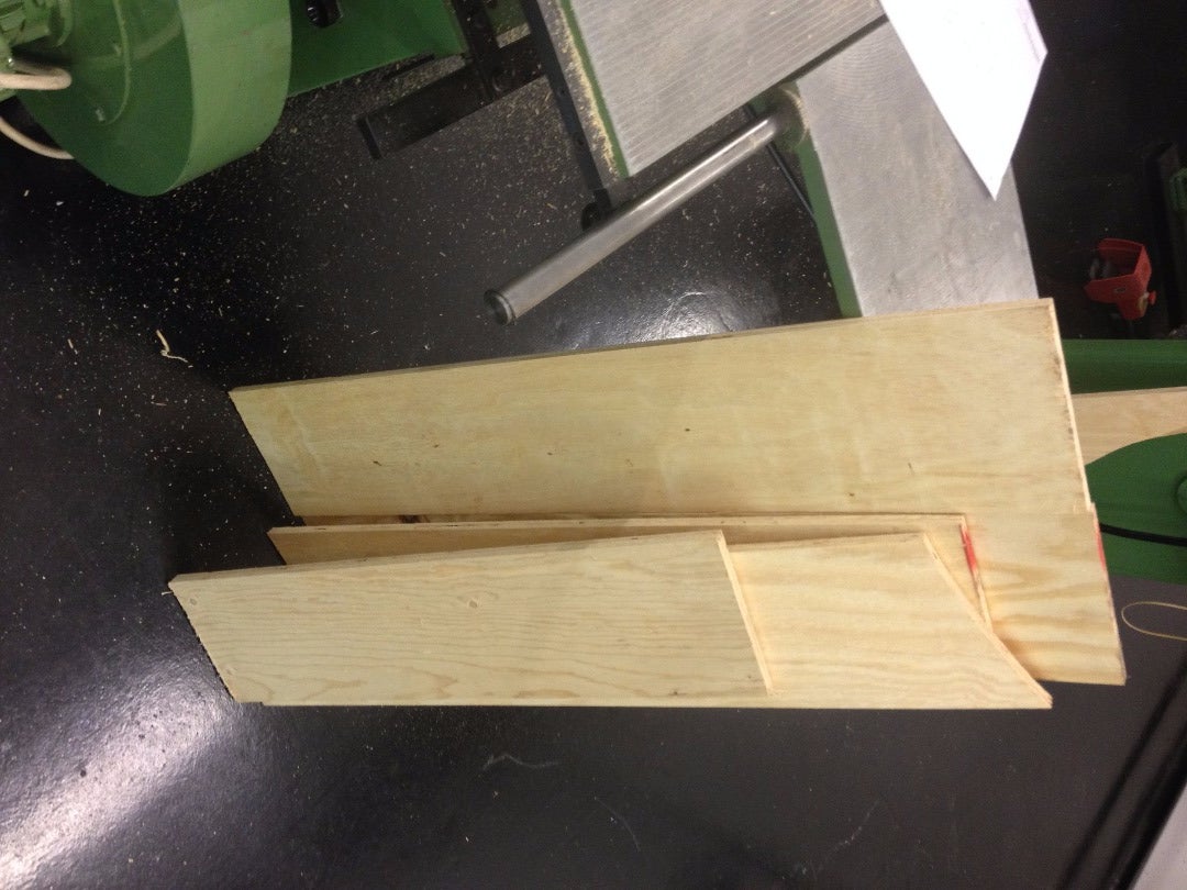

When cutting the plywood, almost any kind of tool with a sawblade will do. Even a handsaw.
But when assembling the boxes, it is important to have as straight sides as possible. It is therefore a good idea to cut the plywood, using a saw table or other easy-to-align-the-board-tools.
Parts
Every box requires five parts:
1x Bottom plate - 402mm x 204mm x 15mm - 15.82" x 8.03" x 0.59"
2x Front/back plates - 170mm x 204mm x 15mm - 6.69" x 8.03" x 0.59"
2x Side plates - 432mm x 170mm x 3mm - 17.00" x 6.69" x 0.12"

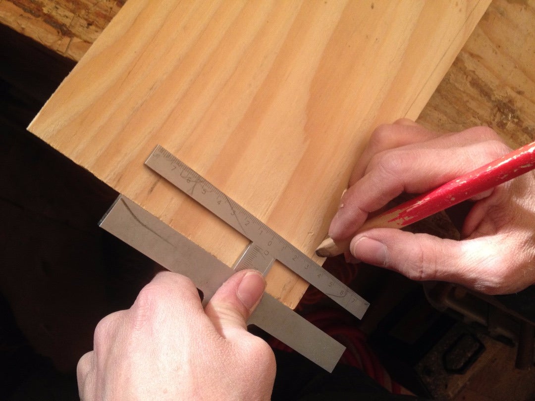

The first step of assembling the box is to fix the front and back of the box to the bottom plate. We started by drawing a line on the front and back plates, 7,5mm from the lower edge.
When doing this, it is important to be very accurate. We used a parallel caliper, to make sure that the line was exactly 7,5mm from the edge.

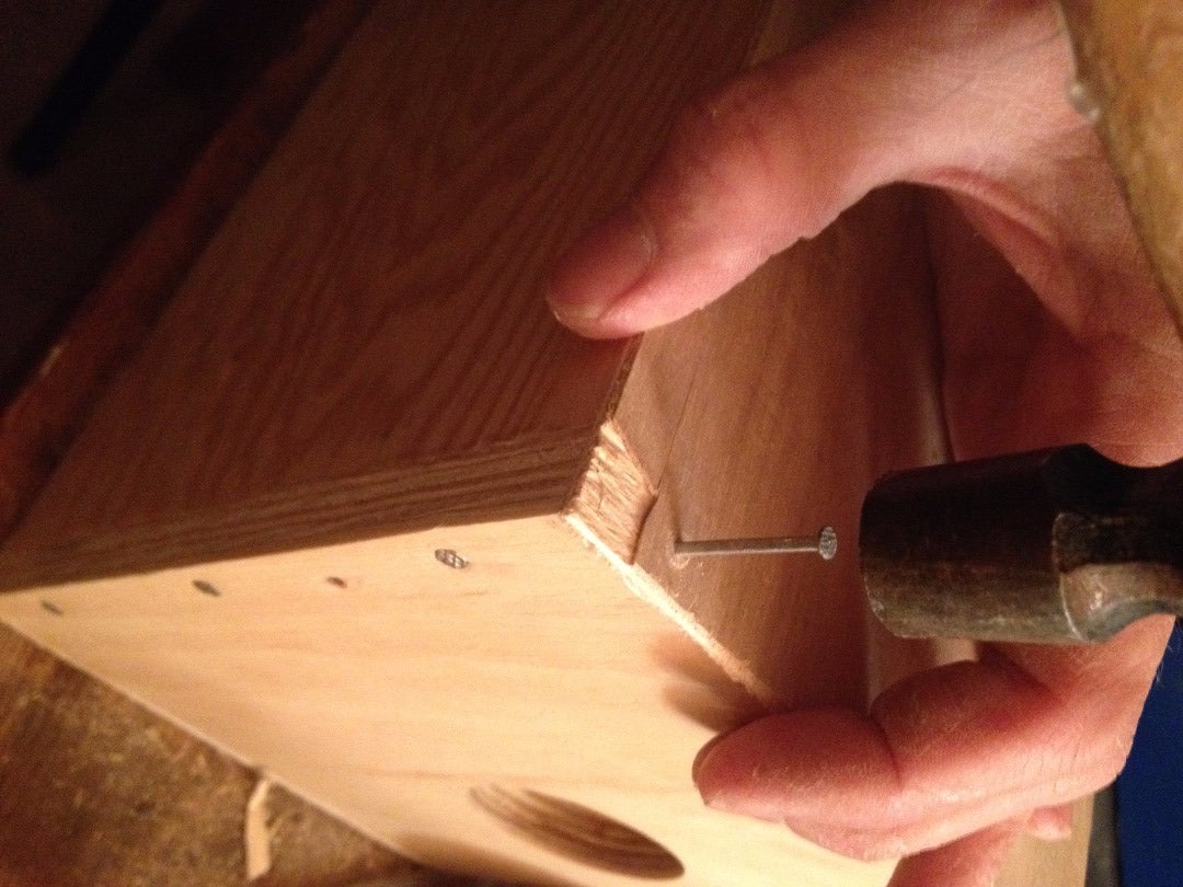

Since the box will be held together by glue and nails, it's important to drill pilotholes for the nails. Without the pilotholes, the chances of hammering a nail into the plywood, without splitting or penetrating the wood, is only slightly higher than transforming two nuclear warheads into a whale and a pot of petunias. So just drill the pilotholes.
When drilling the pilotholes, it's a good idea to line up the bottom plate behind the front/back plate you're drilling. By doing this, you can drill through the first plate, and into the bottomplate. But make sure that they are lined up.
After drilling, you can glue and nail the front and back plate to the bottom plate.

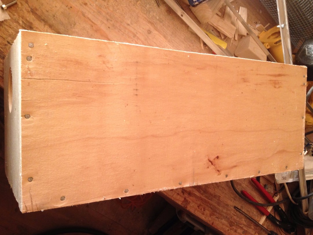

When the front and back plates are fixed to the bottom, it's time to place the side plates. This might be the easiest part. Start by applying a generous amount of glue on the side of the front-back-bottom-part. Then align the edges, and press down the side plate. When the side plate is placed correctly, it's time to continue, by drilling pilotholes for the nails! We used 11 nails on each side, 5 in the bottom, 3 in the front and 3 in the back.
Repeat on the other side.
After drilling the pilotholes and hammering in the nails on both sides... YOU'VE DONE IT :D
Let the glue dry for 10 minutes, and pack your new box with all sorts of stuff!

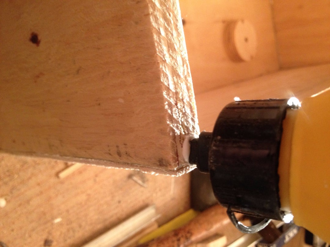

Step 4: "I Didn't Drill Any Pilotholes"
I'm not even mad... That's amazing!
The wood split...
Just like most of earth's problems, it can be fixed. If the plywood have been split, you can easily repair the damage, by filling the crack with glue, and use a clamp or vise to hold it together.
The nail went through...
If the nail went through the wood, and now sticks out the other side while singing Adele, then pull it out. After pulling it out, drill a pilothole inside of the existing hole. Be careful, the tiny drillbit might break! But if you succeed, all you have to do is to hammer a new nail down the pilothole.
