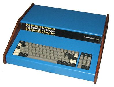

The Sol-20 was an interesting machine. It was introduced in July 1976, appearing on the cover of Popular Electronics magazine. With its 8080 microprocessor and S-100 bus, it had more in common with the Altair 8800s and IMSAI 8080s of the day, than it did with the Apple and Commodore computers that were soon to follow, despite looking more like the latter.
I distinctly remember seeing a Sol-20 in the wild. It would have been the fall of 1977 or perhaps the summer of 1978. I had just started at the University of Waterloo and was visiting my cousin in Toronto. While walking along Queen Street we passed a small computer store and the Sol was prominently displayed in the front window. What a great looking machine with it's bright blue case and walnut sides, but at roughly $1650 (CAD) it was out of my poor student price range.
Only 12,000 were ever produced. Sol-20s are virtually unobtainable today. Because of this I am in the process of creating a Sol-20 reproduction. While detailed schematics and board layouts for the machine exist, the cost of reproducing a Sol-20 PCB and populating it with "vintage" parts would be prohibitive. So I decided to emulate the machine's hardware in software. This is possible because modern computers are orders of magnitude faster than the little 8-bit 8080 microprocessor powering the Sol-20.

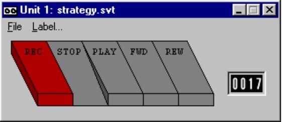

I especially like Jim's virtual cassette interface.
With much attention to detail it faithfully simulates reading tapes at either 300 or 1200 bits per second and will complain if data was "saved" at 300 and you try to read it back at 1200 :-) Of course you can turn these "features" off. Very cool. Thanks Jim for all your hard work.

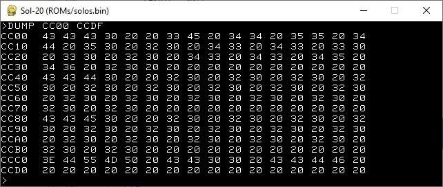

CC00-CFFF - Display RAM. Shared memory between the CPU and VDM-1 video circuit.
Although most systems shipped with only 8K or 16K of memory (or less) in those days, I have to wonder why they didn't map these addresses up into the F000-FFFF space to allow a contiguous 60K memory space for user programs. At any rate the important thing to note for display purposes is the CC00-CFFF shared video RAM. This 1K space was used to store 16 lines of text each of which is 64 characters long. Any text written to this memory would automatically be displayed on the screen.

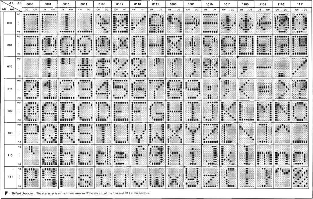

Using PyGame I created my virtual screen. I could have written the characters from the shared video memory directly to the screen but the Sol-20 used a lot of unique character glyphs. These special characters helped to offset the fact that the Sol-20 as shipped did not have a graphics mode.
So based on the original Sol-20 6574 character ROM I created a set of character tiles that I could easily "blit" to the screen. I wrote a function to iterate over the 64 x 16 array of characters in the shared video memory and write them out to the screen and added this function to the main loop of my emulator. When I did that I was rewarded with this. I know the aspect ratio is off here. I'll deal with that later.

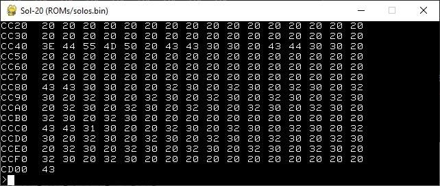

Wow. Still super boring but I see a > prompt so progress. I realized that the display was being updated every time through the main loop so I added a check in the 8080 emulator to set a dirty flag whenever the shared video memory was written to and now only update the screen when the dirty flag is set. Good enough for now.

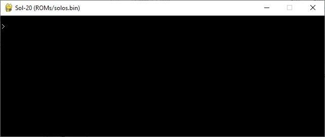

With the virtual keyboard running I can now enter commands to Solos.
A little more interesting. But something is missing. There is no cursor. It turns out that the Sol-20 marks the cursor position on the screen by setting the high bit of the character the cursor is on. The video hardware on the original machine uses this bit indicator to inverse the character at that position (black character on white background) and optionally blinking that character. I added a cursor by doubling the size of my character table with the characters 0-127 as normal white on black background characters and the corresponding characters in the 128-255 range as inverted black on white background characters. This gets me the block cursor that I want. I'm leaving the blinking part as an exercise for future me.

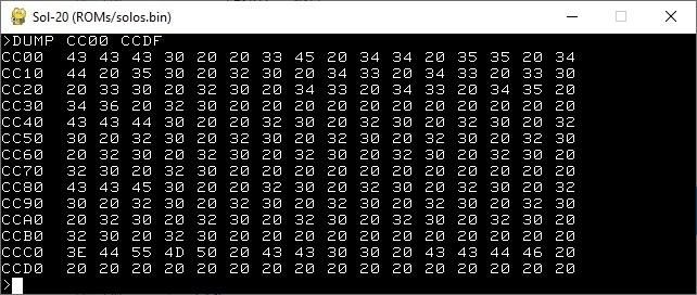

One more thing I noticed was that the display did not scroll as expected with long command results, but instead wrapped from the bottom to the top of the screen.
Sol-20 had a solution for this too. A "start display line" value is continuously output from port 0xFE via the OUT op code. The VDM-1 hardware would use this value to implement scrolling behavior by emitting the lines from the shared video memory beginning with the start display line and ending with the last line to the top of the screen first, then it emits the lines from the start of the shared video memory and ending with the start display line to the bottom of the screen. My display implementation does the same. For the above example the start display line value would be 4.
And here is the "corrected" scroll result.

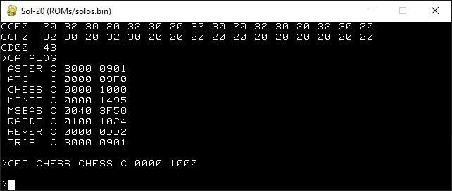

So with the default TAPE1.svt that looks this:
SVT1: Solace Virtual Tape Format 1
F aster.ent
F atc.ent
F chess.ent
F minefield.ent
F msbasic.ent
F raiders.ent
F reversi.ent
F trap.ent

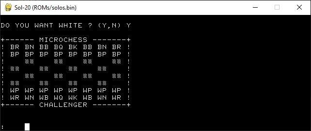

You can now issue the CATALOG command.
Then GET the CHESS game.
And EXECUTE it with an >EX 0000 command.
Finally something interesting!

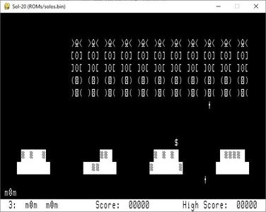

Here is a short clip of my Sol-20 emulator running a Space Raiders game (in attract mode I'm not nearly this good at the game ;-)
