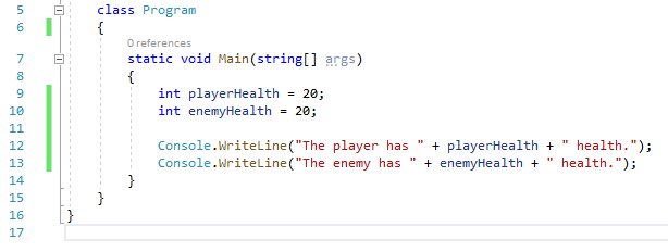

Step 4: Displaying Player and Enemy Health
Now it's time to begin on the actual game. Go ahead and create a new project so that you have a space to work in. This will be a console application using C# and .NET Core.
We'll start by producing something that displays the player's health and the enemy's health. But before we show anything, we'll have to tell the computer what these two things are.
The health is going to be a number that changes when the player/enemy takes damage. Thus, we want it to be a integer variable. We'll do this by first declaring both of the health variables at the top of our code. You usually want to declare variables at the start of your code, since if a part of your code tries to use a variable that hasn't been declared yet, it'll crash. We do that with this:
int playerHealth = 20;
int enemyHealth = 20;
This starts both the player's and the enemy's health at 20. Now we just repeat this health back to the user using Console.WriteLine():
Console.WriteLine("The player has " + playerHealth + " health.");
Console.WriteLine("The enemy has " + enemyHealth + " health.");
Now, if you test the program, it will tell you:
The player has 20 health.
The enemy has 20 health.
You can check the image above for help. This is your reminder to save your script, which you should be doing whenever you finish a change anyway.

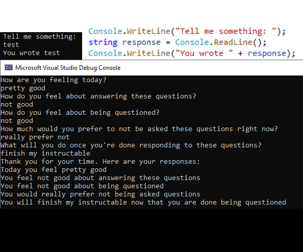

Step 8: Getting the Player's Command
Again, the gameplay for this game consists of the player saying whether they want to attack or defend. We need the game to first ask the player what they want to do, then run the correct code depending on the response. We'll first add Console.WriteLine(); within the gameplay loop (the while loop that contains everything) but before Console.ReadLine();. In it add some message explaining to the player that they should type "attack" if they would like to attack the enemy or "defend" if they would like to block the enemy's attack.
Now we want to assign that blank Console.ReadLine(); to a variable. Add string to the very start of the line with Console.ReadLine();, then make up a new name to describe the player's choice (such as choice or playerChoice) to write immediately after. To finish, follow it up with an equals sign. Doing it like this creates the variable with the reading of the player's input, which by extension makes it a part of the while loop. Due to how C# works, variables only exist to anything within the curly brackets containing the variable's declaration. This makes it slightly harder to develop at first, but it also makes the program run slightly better and organizes things. The reason we want the response to be recorded within the loop but not the health is because the response is only used within the loop and is set again every time the loop runs. The health is also only used within the loop, but it should remain the same value when the loop starts again as it was when the loop ended, thus we declare it outside of the loop so that the loop doesn't reset them by declaring them again.
After the code that reads the player's input, set two if statements and curly brackets one after another. One should check if the player's input reads "attack" and the other checks if the player's input reads "block". For now, just put a line of Console.WriteLine(); in each set of curly brackets with a message about the option that it's in. You should also add a line to the attacking section that removes 2 from enemyHealth, and if you want, add that you dealt 2 damage to the Console.WriteLine(); string too.
Now you can save and test your program. Depending on what you enter, it should either print your message about attacking, print your message about defending, or do nothing if you entered neither. If you have trouble, check the image above as a reference.
