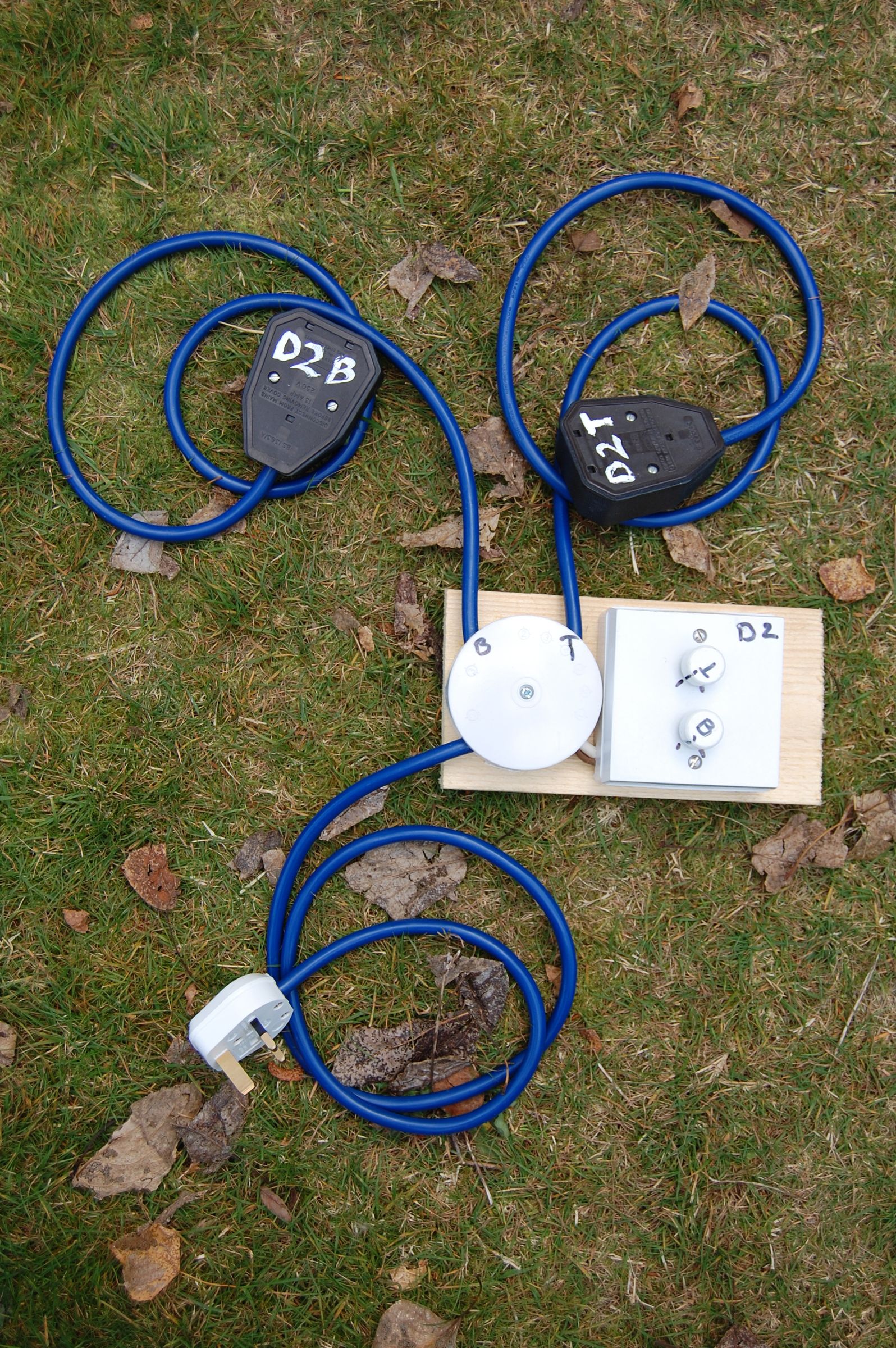

Step 6: Lighting!
One big 300 Watt Clear ES bulb is fitted into an ES Bulb holder which is permanently screwed to the centre upright.
I wanted the Time Machine to pulse with light, so I bult these dimmer switch boards. I will detail these in a separate Instructable, because they are so useful and I didn't actually make this one for this project.
Basicly it is a double gang dimmer switch (rated to 400 Watts) with a single input and 2 outputs, and all labelled for convenience.
