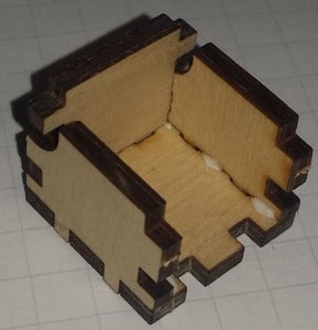

Step 1: Poke Out the Pieces and Start Assembly
Carefully poke out the pieces.
  • If you hold the panel up to the light, you will see little tabs holding the individual pieces to the panel.
  • Apply pressure to the border at the tab holding the piece in place, the piece will usually break free,
To start, you will need
  • Back, both sides and bottom (shown)
Note: Careful not to confuse the front and back pieces. The back piece is taller.
Note: The sides are interchangeable.
Add a SMALL amount of glue to the mating surface on the BOTTOM PIECE ONLY
Note: The point is to keep any glue away from the hinge pins
The curve in the side pieces goes next to the hinge pins (see the picture)
After the bottom, sides and back are glued, find the front piece.
Add a SMALL amount of glue to the mating surfaces (bottom and sides)
Attach the front piece and squeeze the pieces together slightly.
Each tab should be fully seated into its adjoining slot.

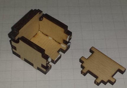

Step 2: Gather the Pieces for the Top.
Now that the bottom part of the box is complete, it should look like the first picture.
Now find the top, top sides, and top front pieces.
The pieces are shown in the picture in their correct orientation

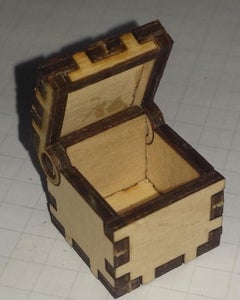

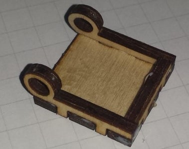

Note: The top piece has a straight edge without any slots. That is the back of the box lid.
Apply a small amount of glue to the mating surfaces on the TOP PIECE ONLY
When assembled it, will look like picture 4

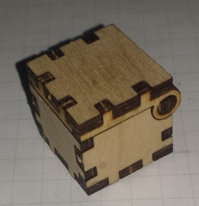

Step 3: Assemble the Top to the Box
While the glue on the top is still wet,
While the glue on the top is still wet, put the top on the box.
Note: It will be necessary to move one of the top side pieces outwards a little bit so that it can slip over the hinge pin (as shown in the picture)
Once the top is in place, squeeze the box on all six sides (Slightly, remember its 1/8 inch plywood) to make sure all tabs are in their slots
Its not a bad idea to open the box carefully a few times to make sure that the lid is not glued down.
Note: The lid may be difficult to open if the perimeter of the top side pieces have been charred during the cutting process. A little (tiny bit, small amount, hardly nothing) lubrication ( olive oil, mineral oil, butter) on the perimeter will usually take care of this.
Allow the glue to dry for a few minutes before handing the box to someone.
