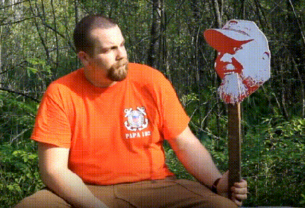

I use the border of his face to trace around on the bandsaw and cut it down to size. The beard is pretty tricky, but I made it work.
Then I sand down smooth the edges that I can reach with the sander.
I can't help but feel like I'm being watched...

Step 6: Glamour Shots
I use one spring on each side of the mouth pointing slightly away from each other to make sure that they pull it back into the corner where it meets up with the rest of the face.
And it's officially alive!
