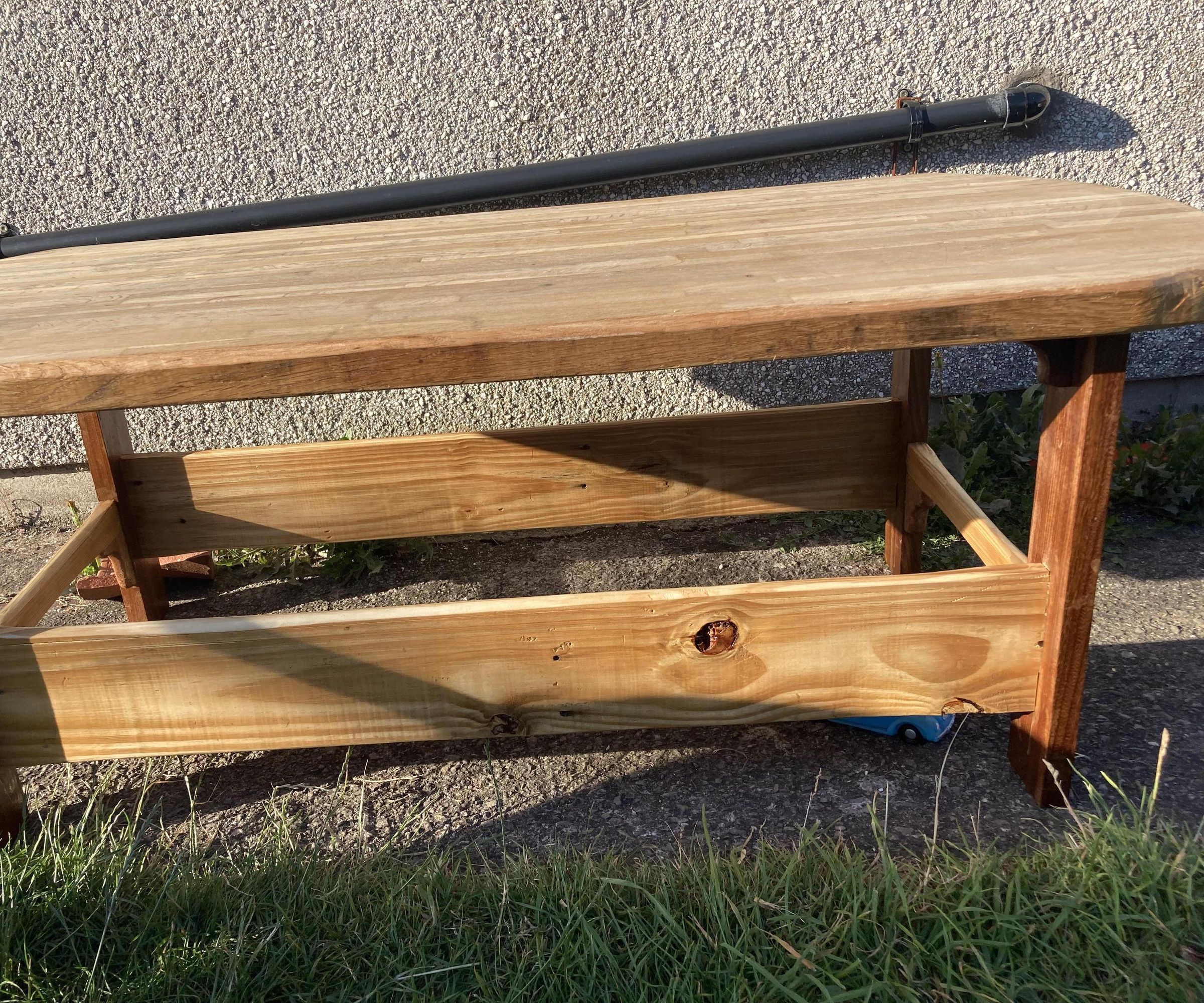

Step 6: Final Lay Up and Gluing
Having glued the well board I now needed to build up the back side of the well. This was simply a laminated stack of pallet boards.
Once this was made and I could select the stringers for the bottom of the well and cut the sloped ends of the well board from pallet blocks.
All of these being selected and having been checked by laying out without glue, it was clear the overhang from the front of the Bench was not sufficient. I dropped some more planks in half and and glued them to the front half of the bench to create the overhang for the well board.
This having been completed, the well board was glued together in position with cling film in place to make sure it wasn't stuck to the front half. Keeping the sections separate would mean in the future I could repair or replace the elements if necessary and would make it possible to dismantle the bench and move it more easily.
I then found the overhang over the well board want deep enough. To fix this I ripped some boards and glued them on to extend the overhang.
This completed, I used a saw to cut the bevels on the end blocks and glued them in place along with the base of the well and the back of the week board.
With this done, the basic bench was complete and it just needed finishing.
Step 7: Final Bench and Finishing Touches
To finish the bench, it needed levelling. This was not as trivial as it sounds as all I had was a no 6 hand plane to do it with. I love just using hands tools but this job did make me wish for a power planer!
With this done I put a vice I bought off ebay on to the front. I did toy with building an end vice into it but life is too short and I wanted to get on to building other things.
I also bought some hold-fasts (which I really like) that came with an auger and drilled holes for those. I didn't do many to stay with until I used the bench a bit and figured out where they would be useful.
And that is it. A bench made pretty much entirely from pallet Wood to a design I pretty much made up as I went. More detail than you probably wanted but if this gets read by anyone other than me I'll be amazed.
