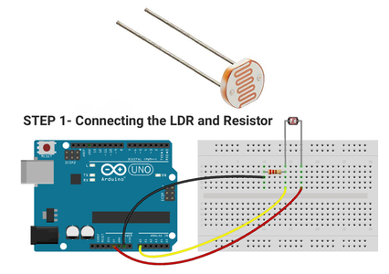

Step 2: Electronics !
In this step, we’ll assemble the electronic components that allow the Arduino to sense light and control the mechanical pupil. The setup is quite simple and beginner-friendly.
> Note: I’m attaching photos of the connections separately, as I’m typing this from my phone and don’t have access to make a Fritzing diagram right now.
How It Works:
We use the LDR and a 10k resistor to form a voltage divider. As the ambient light level changes, the resistance of the LDR changes — this alters the voltage at the junction point between the LDR and the resistor, which is then read by the Arduino’s analog pin. Based on this value, the Arduino sends a corresponding PWM signal to the servo to adjust the aperture size.
Wiring Instructions:
Here’s how to connect the components:
1. LDR and Resistor (Voltage Divider) :
  1. Connect one leg of the LDR to 5V on the Arduino.
  1. Connect the other leg of the LDR to Analog pin A0 and one leg of the 10k resistor.
  1. Connect the other leg of the resistor to GND.
  1. This forms a voltage divider: the analog voltage at A0 will change with light intensity.

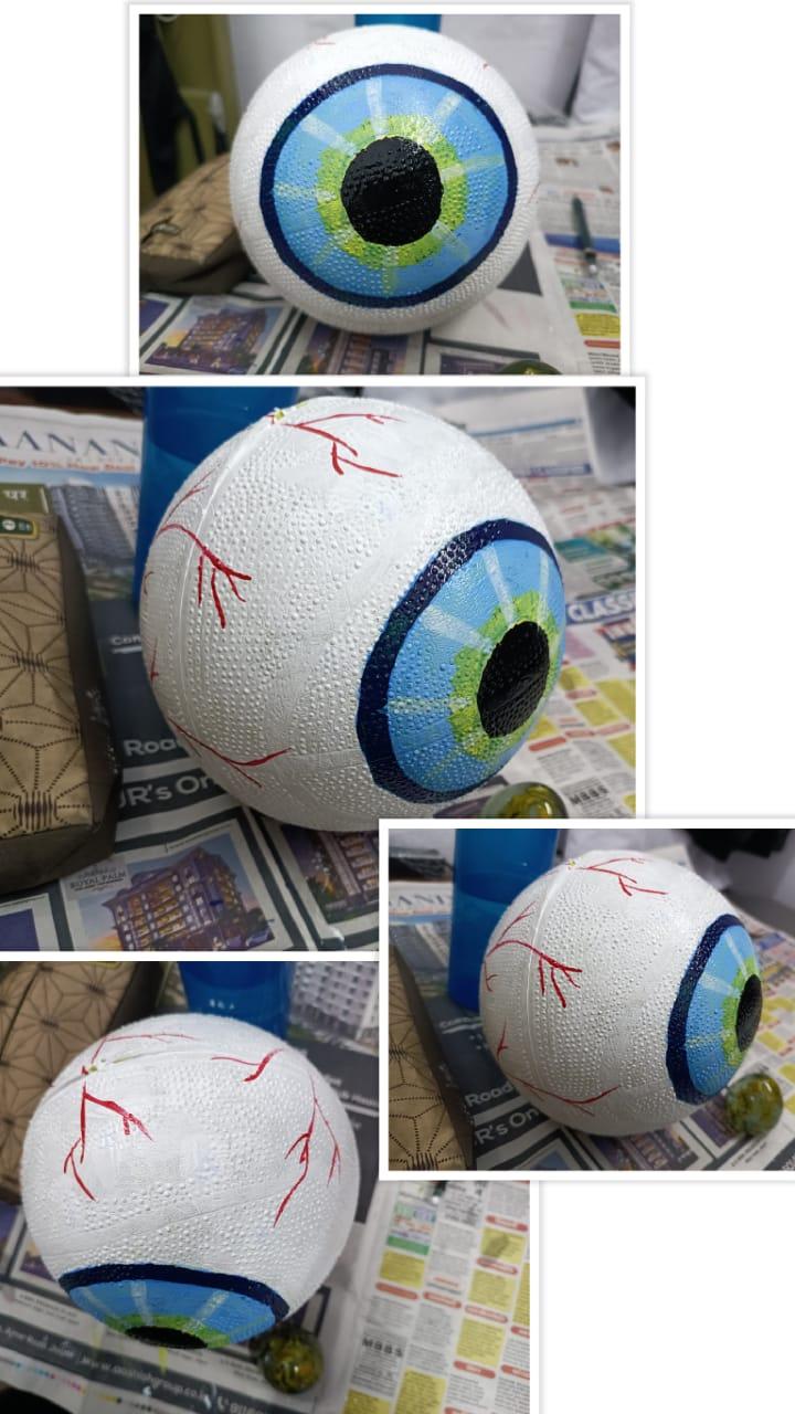

Step 6: Painting and Aesthetic Enhancements
To make the project not just functional but visually engaging and educational, I spent some time on painting and detailing — giving it the look and feel of a human eye and adding a creative visual pathway demonstration.
Painting the Wooden Base and Frame:
I coated the wooden base of the project with a rich Prussian Blue shade using spray paint, giving it a sleek and clean finish.
For the wooden frame holding the iris diaphragm:
  1. I first applied a layer of white watercolour as a base.
  1. Then, using black watercolour and a sketch pen, I detailed the frame to mimic the external anatomy of the human eye — making it look more realistic and eye-catching.
  1. This black-and-white contrast helped highlight the moving diaphragm and simulate the sclera and pupil appearance.
Creating a 3D Eye Model:
To enhance the visual representation further:
I painted a spherical ball (to represent the eyeball) using various watercolours, simulating the iris, sclera, and pupil.
This gave a 3D appearance of a human eye, useful for both display and teaching.
