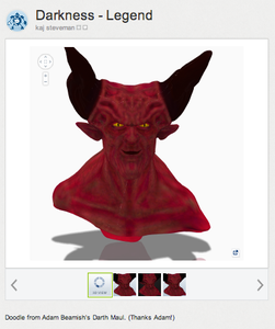

Step 1: Pick a Model From the 123D Gallery.
There are sooo many great models coming out of 123D Creature - and most users are happy that you use their work. (Just attribute the original creator, it's considered polite.) Browse through the gallery and find one that is relatively simple - not a lot of overhangs or negative space. Also, the material thickness and scale are directly related to the resolution. In other words, the bigger the model and the thinner the material, the better the resolution of your final piece. So, don't pick a model that would rely on the detail coming through.
I figured the two giant horns are not going to get lost, so let's do it to it.

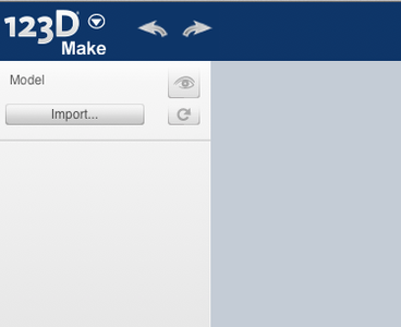

Step 2: Import Into 123D Make
If you haven't already, create an Autodesk 123D account and download 123D Make
There are a few ways to get a model into 123D Make, but first, you'll need to launch the browser version or download it directly to your Mac desktop. Whichever platform you prefer will dictate how to get the model to open.
- (Browser) Directly from the model's page, via the Edit In... dropdown on the right - click 123D Make
- (Desktop) Save/Download the STL to your computer then use the Import button at the top left when 123D Make opens
I prefer the desktop version - it allows me to work on something and walk away without gumming up memory in Chrome.
Once you've imported your model, some new settings menus will populate on the left sidebar.
