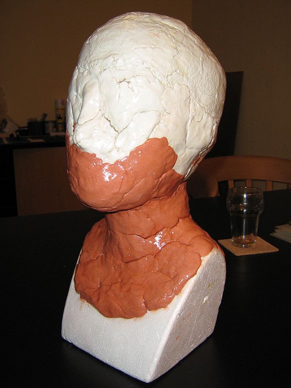

This is also the step where the head mannequin comes into play; the mask in progress is placed on it. As said, this step can take multiple days. Being stored on the head will prevent undue warping while the masks gains in layers and thus in strength. If you do this step with the mask resting on a 'generic' mold, it's entirely possible the end result will be too big or too small for your head.
