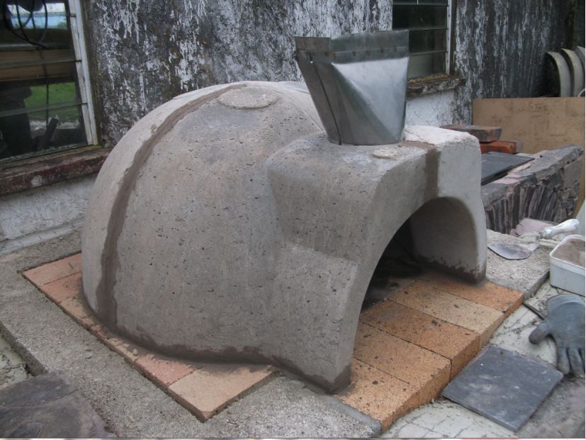

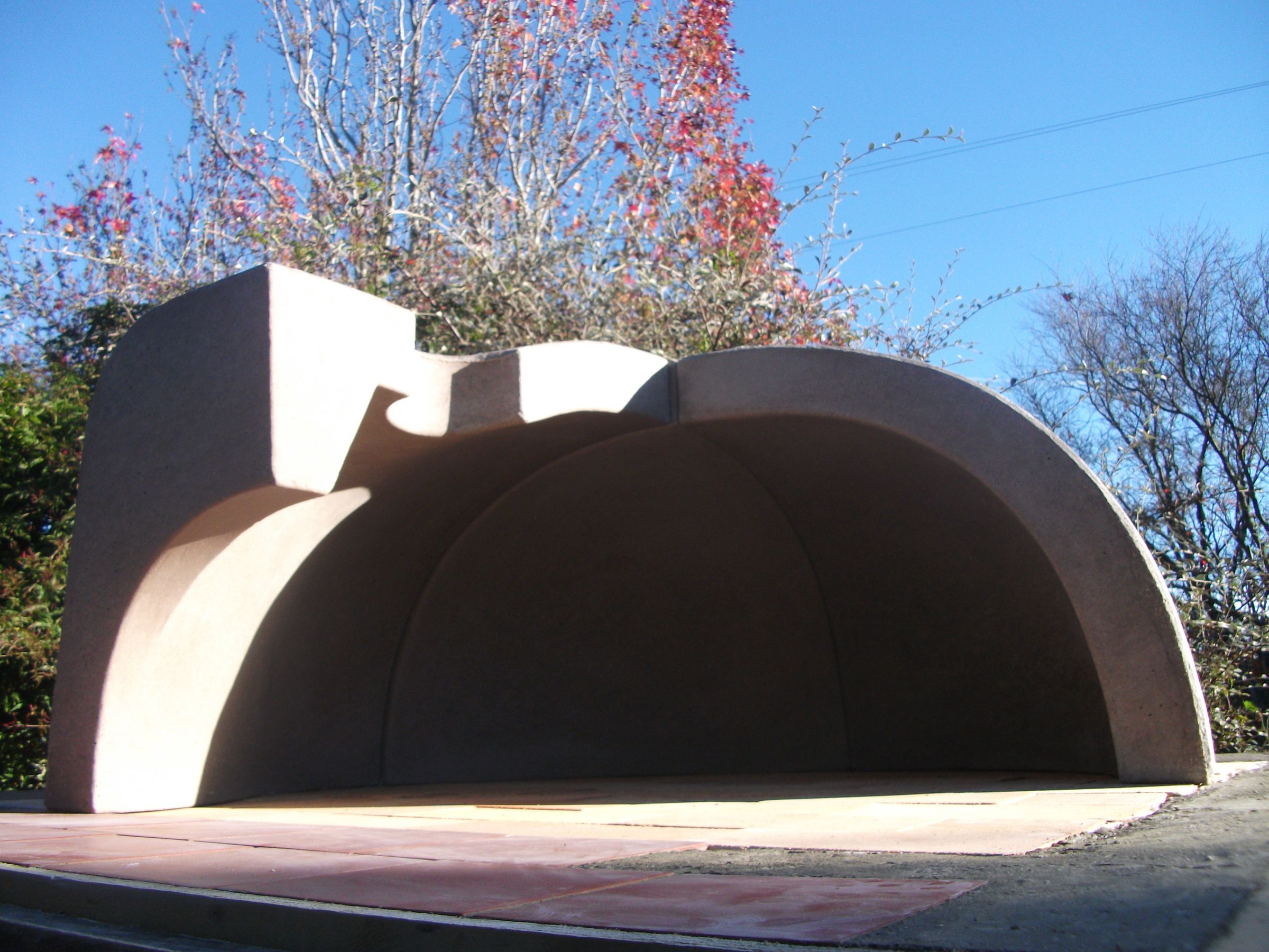

When you made the front arch of your oven you would have already made the cutout template for the door, this should be almost perfect... but may need a little adjusting, in this case it was good as i used a 3mm layer of MDF over the curve which will leave me with 3mm of a gap around this template.
As we only have 3mm of room to play with and want to make a snug fit, once you have drawn your template onto your wood you want to remove the line when you cut... not leave it... that's about 1mm or more extra if you leave it.
Once you have cut it though, pop it in your oven gap and check and adjust in any spots if you need too.
