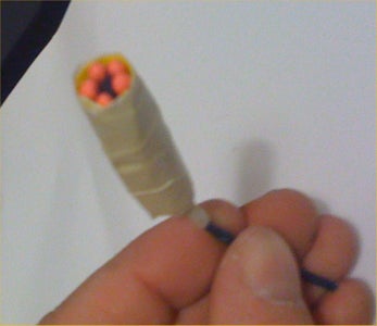

Step 5: Hold Sleeve
now we can make the last sleeve, this will be used so we can hold on to the igniter, it will also act as a shield for your hand when it ignites.
cut another strip of paper as long as the width of the sheet of paper, and about 2-3 inches wide.
now this is important, make sure the edge of the paper is past the point where the match heads will be, this has 2 purposes, 1. it protects your hand when it ignites and 2. it acts as a wind break so the matches dont go out.
roll the paper in to a tube and tape the tube together, taking care not to tape it to the other sleeve.
then fold the back of the tube in to a point around the fuse and tape it in place, as well as taping it securely to the fuse.
you should now have about half an inche of fuse poking out the end.
and that is your igniter done.
