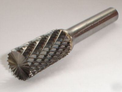

Carbide Burr - This was the second biggest time saver. Luckily I had a brand new carbide burr as well as access to a pneumatic die grinder. You could also use a Dremel tool with a smaller carbide burr but I would suggesting not doing long griding sessions or you could burn out your tool

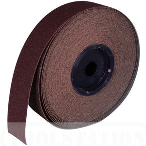

80 Grit Emery Cloth - This will help smooth out and remove all the marks left from the belt sander and die grinder
