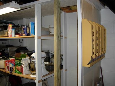

Introduction: Making a Roll Out Storage Cabinet.

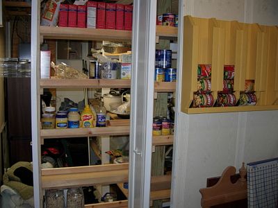

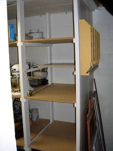

Our house has very little kitchen storage, so we are forced to use every space available. There are some existing shelves in the basement that were installed by the previous owner, but they are so deep, front to back, that when canned food, or anything else for that matter, is stacked on them you can't see what everything is.
The existing shelves are 32" deep, far to deep to be practical for the canned food storage that we wanted to use them for.
As you can see from the junk on the shelf to the side they aren't bad for storing bulky items.
The frame for the shelves is about 84" tall and 22" wide that's almost 5 sq. ft. per shelf so it really has a lot of potential, but just doesn't work as is.

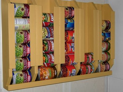

This project actually started with the First In First Out rack that is mounted on the end cap of the shelves. It worked great, but just didn't hold enough.

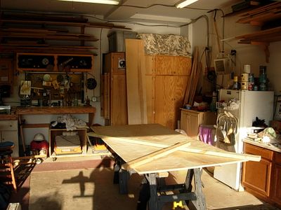

Step 1:
Me getting ready, and part of da shop.

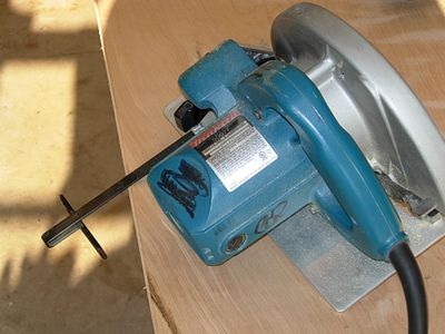

A quick word about safety.
Power saws are sharp. They hurt really bad when you get cut. Don't put body parts near saw blades.
I know that I show my saws without guards and with guards retracted, but I have been doing this for a long time and have a true fear and respect for these tools. I have seen what they can do to the human body, it ain't pretty. I in no way advocate using power tools without proper safety guards, this is just the way I do things. You are responsible for your own actions if you use tools such as the ones portrayed here.

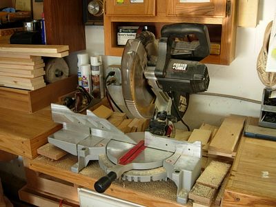

Step 2: Tools and Material
Everything in this project is re-purposed material from my shop. The only thing that I actually bought was the sheet of plywood that was left over from another project and the handles. Even the paint is a left over.

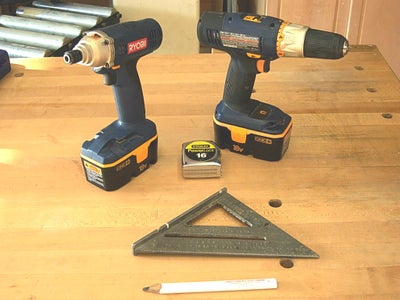

The list of tools is long but I have them in the shop so I use them. By no means do you need all of this to make this project.
- Table saw.
- Drill press.
- Circular saw.
- Miter saw.
- Cordless drill.
- Cordless impact wrench.
- Speed square.
- Tape pencil.
- Clamps
- Nail gun. (Not pictured.)
- 4'x8' sheet of cabinet grade 3/4" plywood for the trim faces and shelf carcasses.
- 2"x8" for the bases.
- Old shelves cut down for the new shelves.
- Old 1"x3" shelf runners re used for new shelf braces, guides, and runners.
- Casters salvaged from an old frig.
- (2) Handles
- 1 5/8" drywall screws. (Not pictured.)
- 1" lag bolts. (Not pictured.)
- Door casing.
- Primer and Paint. (Not pictured.)

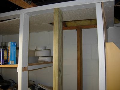

Step 3: Old Shelves Gutted.
The first obvious thing to do was to remove the old shelves and runners. Easy to do since the shelves weren't attached, and the runners just screwed on.
Step 4: Figuring the New Shelves.
I decided on two shelf units so that everything is accessible from each side of each unit.

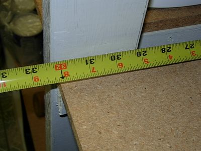

Starting with a 22" wide rough opening,
Minus 1 1/2" for the center post, = two bays at 10 1/4" each.
Minus 3/4" each side of each bay for guide rails= 8 3/4" wide for each shelf box.( You will see the guide rails in a later step.)
Next was figuring the height.
84" from floor to ceiling minus 4 1/2" caster = 79 1/2".
Minus 1 1/2" for existing top plate = 78".
Minus 1 1/2" for 2" x 8" base = 76 1/2".
Minus 1/4" for a little play for the uneven floor, ceiling, etc.=76 1/4 box for the actual shelves.

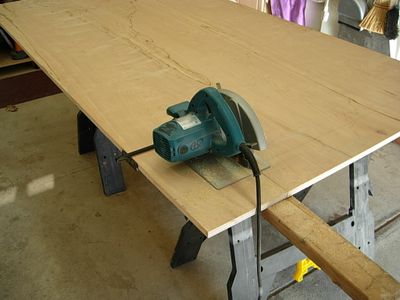

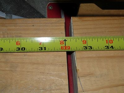

Step 5: To the Shop!

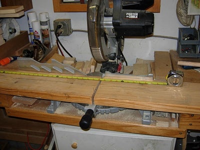

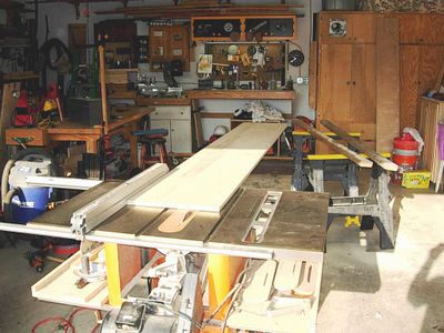

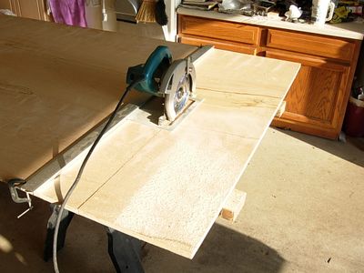

The first rough cuts were to get a full sheet of flat stock down to a manageable size.
The first cut was across the width, making a sheet that is now 84" long, the rough overall height of the frame. Future cuts will be made to finalize finish sizes.
Now I rip the trim faces first to make sure that I have these important pieces first. After that I rip as many box pieces as I can out of the rest of the sheet. I got lucky and only needed to find one end piece for one box to complete the both boxes.
I'm not going to give all of the dimensions for the boxes, you get to figure that out for yourself.
I know that I added a step with the rough cuts and then recutting them, but as I said before, this was a design as you go project.

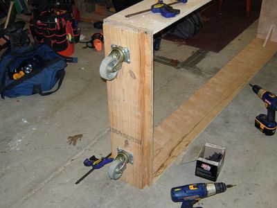

Step 6: Now the Bases.

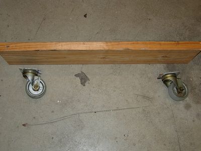

Since the cabinet is going to hold a fair amount of weight I needed a good solid base to mount the wheels and to set the shelf box on. Because the shelf box is 8 3/4" wide a 7 1/4" 2x8 worked out pretty well, especially since that was what I had on hand.
Frame bay is 32 deep, so base is 32" as will be the box.

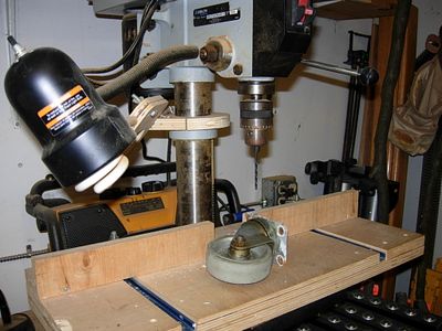

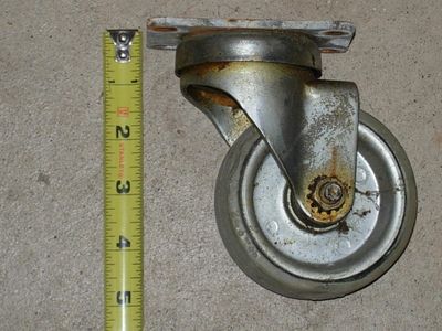

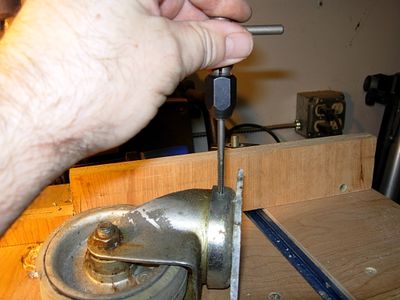

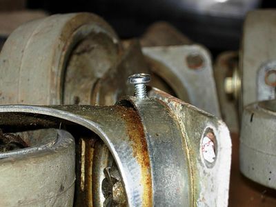

Each base will only have two wheels because I only had four to begin with. You will see later how I dealt with the problem of keeping everything from tipping over on this bicycle rig.
With the casters being swivel, I needed to lock them in position to stabilize the units when in motion. On two wheels I only wanted movement front to back not side to side.

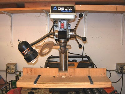

Off to the drill press.
I scrounged four screws the same size and ones that matched a size of tap that I had in a small set I had. I drilled a hole in each swivel housing, then tapped threads in each, and add locking screws. This was not the perfect solution, and if I have it to do again I would probably change it, but it worked well enough to hold the casters in a straight line with the base.

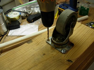

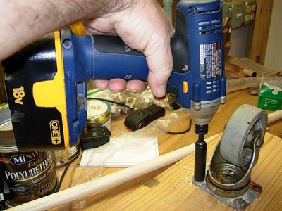

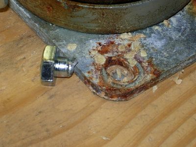

Now to mount the casters to the base.
Casters are centered side to side, and far enough from the end to clear the existing plate in the back of each bay.
Pre drill for the lag bolts.
Install lag bolts.

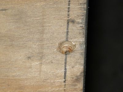

As you can see in the last picture, you have to be careful with the impact wrench you get broken bolts. This can happen just using a hand wrench, but not as easily.

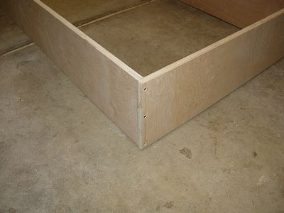

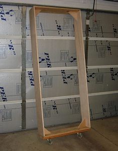

Step 7: The Box to Set on Top.

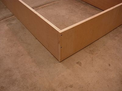

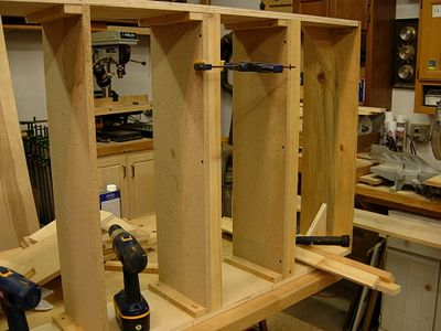

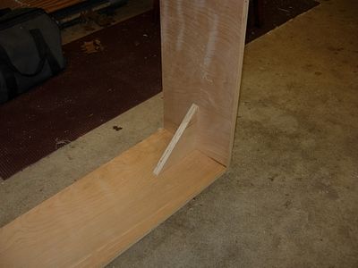

Now I made a simple plywood box to set on the bases and hold the shelves. The box measures 76 1?4" tall x 32" deep x 8 3/4" wide.
Running a full sheet of 3/4" plywood through a table saw by yourself is not the easiest thing in the world to do, but the table saw gives much cleaner cuts, so first I used a circular saw to rough cut the full sheet down to manageable size then finish cut them on the table saw. I could have done it all without the table saw, but if you have the toys, why not use them?
Boxes are screwed together with 1 5/8" drywall screws, 3 to each corner, drilled and countersink. You can use wood screws, but dry wall screws are a lot cheaper and I already had them.
After the boxes were all screwed together, I cut some scrap pieces into 45 degree corner braces to help keep the boxes from racking, one for each corner.

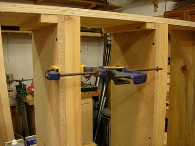

Mount the boxes onto the bases with more drywall screws, 6 per box. The clamps are used as helping hands to hold things together while the screws are installed.
The last picture shows the mounted box standing upright with the casters locked in place.

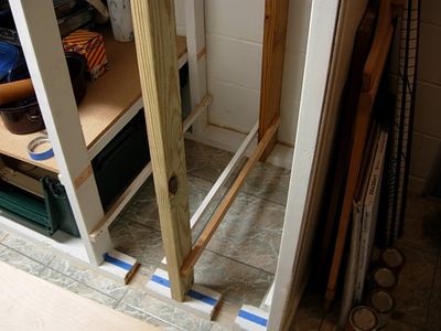

Step 9: Getting Ready to Install.

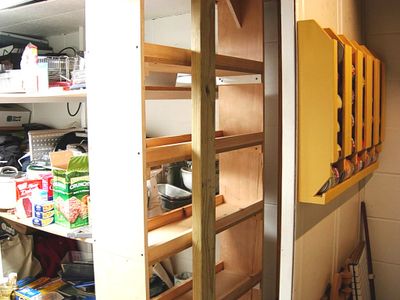

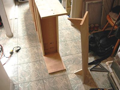

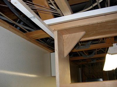

Installation was a bit of a challenge. With only two casters on each box, keeping the units upright is a real issue.
The solution was to install guide rails at the top and side to keep everything in line.
At the bottom the guide rails match the height of the side rails of the bottom shelf.

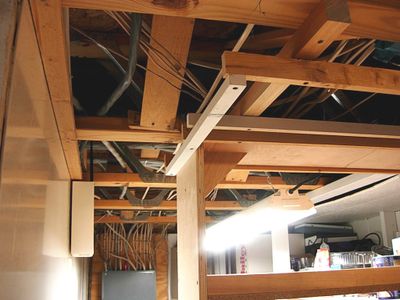

Most of the bottom frame plate was left in to give support to the center post with enough removed to allow the casters to pass freely.
At the top the guide rails extend out on the ceiling so that when the shelf is opened it wont topple over. A spacer was needed so that the guide rails could pass under both the front and back frame plates. The height of the cabinet is tall enough that it can't come out of the rails as long as the casters stay in line so that the bottom can't slip sideways.
Now it's a matter of making sure the casters are locked in line with the guide rails so that the box rolls freely in and out of the frame. This might take a little playing with, but when you get it done right, the box probably wont even touch the guide rails at the bottom.
The shelf boxes are installed in the frame by tilting the top of the unit over into the guide rails then sliding the bottom over until bottom is plumb under top.
A stop bar was then installed to keep the units from coming out to far. It was set so that the back of shelf box stays inside of the frame by a couple of inches.
In the last picture you can see that even a genius like me can have a , well , an error in judgement, let's say.
The boxes came out a little to tall and rubbed the top plates so I had to do a little field modification.
Since I hadn't glued the box together, all I had to do was remove some screws, pop off the top of the box, trim the side down, and reinstall the top. Simple.

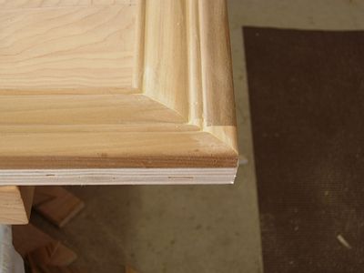

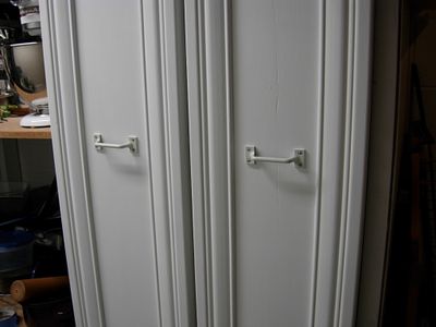

Step 10: Final Touches.
These last few steps are probably the easiest.
The trim face is simply a piece of 3/4" plywood sizes to over lap the frame by about 1/2" to 3/4" on the sides, and very close to the floor and ceiling at the top and bottom. At the bottom the trim panel covers the caster when closed.

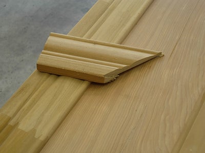

The panel is the trimmed with some door casing that I had on hand the was left over on a house building site. Yes, it was given to me!
The casing was cut with simple 45 degree miters, and nailed with 5/8" trim nails and a nail gun, making sure to stay flush with the edge of the plywood all of the way around.
Fill the nail holes with wood putty.
Sand smooth.
A coat of primer, two coats of acrylic latex.
Add a handle. (A tip. install the handles before painting, then remove to paint. This way you can mark where the handles go without messing up the paint. Also you now have the screw holes in place so that the final handle is easy breezy.)
Done.
