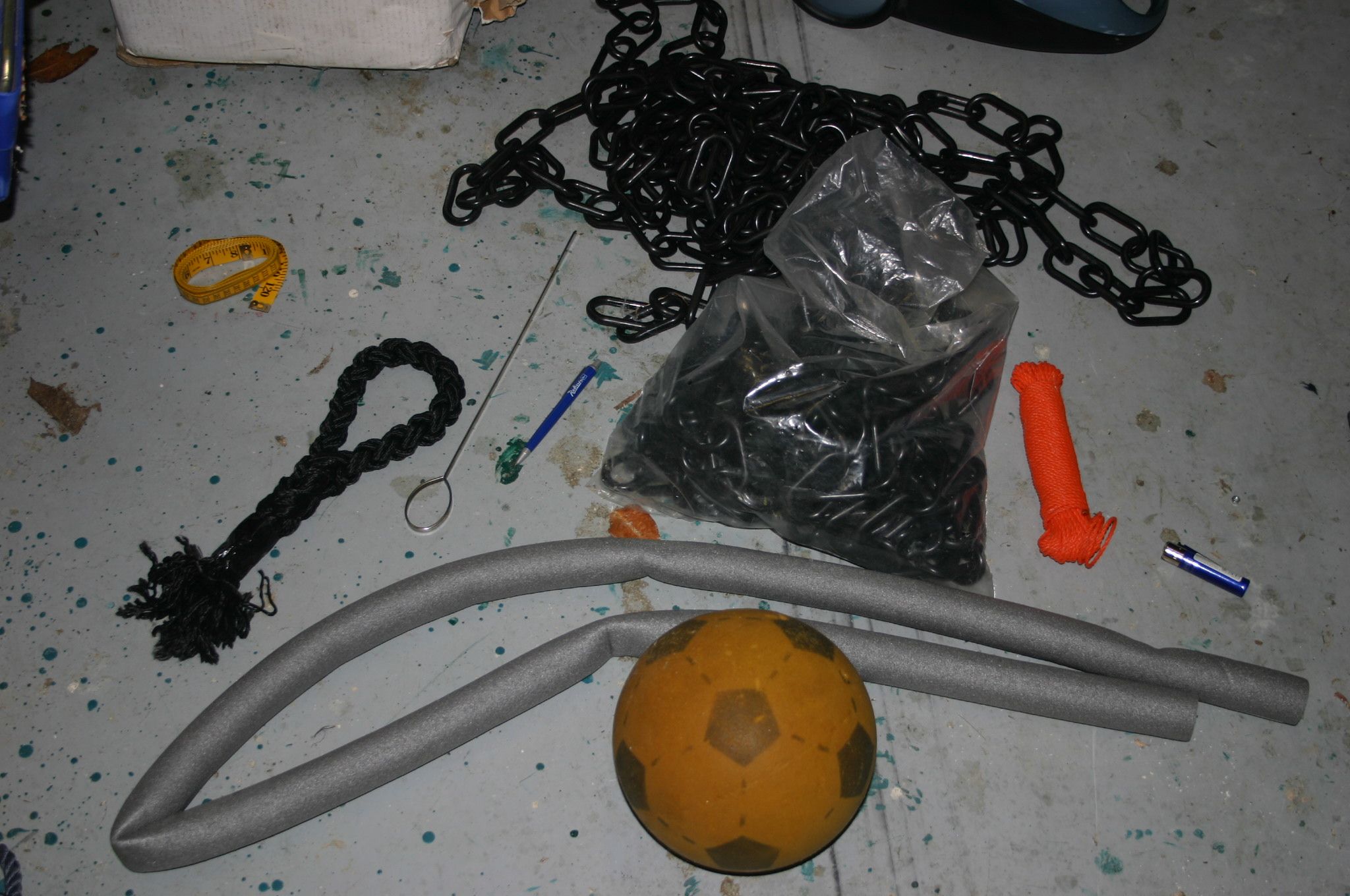

Introduction: Making a Rope Handle for a Jugger Chain
This instructable is part of a series looking at manufacturing equipment for use in a sport called "Jugger." Jugger is a game derived from a 1980s action flick called "The Blood of Heroes" written by David Webb Peoples (12 Monkeys, Blade Runner, Unforgiven) and can be thought of as being like rugby with weapons. An example of a game can be seen here.
The chain is arguably the mightiest weapon on the Jugger field, those fail to argue so often end up facing an irate chain player. But what the cowering staff-player facing three meters of rage fails to realise, is that even the most frightening chain has a humble beginning. A seed, if you will, from which it's fury sprouts. This is the story of how to plant your own seed...
For this instructable you will need...
-Some cable ties
-A lighter
-Some synthetic rope (I used doubled 8 strand polyaramid, but the process is much the same for other braids)
-A glass of water (Not pictured)
-Electrical tape (Optional)
-A marlinspike (I used a cooking skewer and a biro due to marlinspikelessness)
-A breadknife (Or other serrated blade, a hacksaw would do quite well)
Also pictured are a craft knife and a scissors, I'd forgotten quite how tough polyaramid rope is and they turned out to be pretty useless.
Sourcing rope: This is an excellent project to use up spare bits of rope you might have lying around. So long as they're twisted or braided rope they should be fine. Compound ropes with cores tend to be too complicated to braid. If you don't have any old rope, a chandlers (boat shop) or hardware shop are a good bet.
The basic idea is to create a loop which easily fits over your hand, with two tails spliced into each other to serve as a handle. If you've never spliced rope before I recommend starting with a simpler braid of rope, but it is simpler than it looks.
