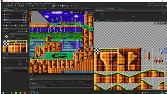

It took a bit of effort to put the different games onto the arcade machine. What I had to do was get the URL, because most of the games that I put on the machine were made in scratch, and then run a script that would open the website in Google Chrome in fullscreen mode. Some of the games weren't made in scratch, such as the ones made in Gamemaker by Logan Meister and Ethaniel Cabrera, would need to have specific files made to launch them. The way the games would be controlled was through the two joystick controllers mounted on the front of the arcade cabinet. These controllers would then have their inputs converted into mouse/keyboard inputs by a program called xpadder, which is very easy to set up and use.
