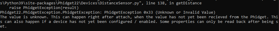

As I mentioned earlier the Sonar Phidget can only measure distances as close as 40mm, but it also can only go as far as 10m. The latter isn't likely a concern, as 10m is a long distance for this litter rover, but the former may become an issue.
If your rover gets too close to something before measuring the distance, it can throw a PhidgetException. Although usually this will stop your code, there are things that can be done to mitigate this. The first and most easy thing to do is to either lower your MOTOR_SPEED or increase your TRIGGER_DISTANCE and SAFE_DISTANCE for obstacle avoidance, but that's not your only option.
You could also add a try-except statement around your measurements. This way when the Sonar gets too close and throws a PhidgetException error, instead of your program breaking you can just start your avoidance code. That might look something like this:
while True:
  try:
    if Sonar.getDistance() < TRIGGER_DISTANCE:
      # Avoidance code
    # Move forward again
  except PhidgetException:
    #Object is too close to sense, start avoidance code
The only thing to watch out for is that the Distance Sensor isn't the only thing that can throw a PhidgetException, and blanketing the error may result in false positives, or weird program behaviour.

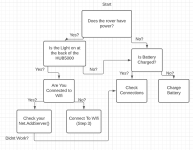

Step 6: Troubleshooting
I have provided a basic troubleshooting flowchart above. The most common issues occur when not connected to the rover's wifi, and when the distance sensor gets too close to something as mentioned in Step 5.
If this is your first time working with the Phidgets Rover Kit and you are completely stuck, I would recommend going over the setup and testing instructions thoroughly, provided here on the Phidgets Education website.
