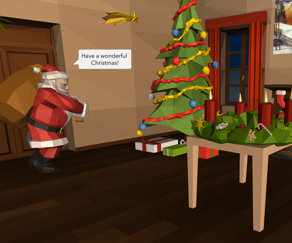

Step 4: Add an Interactive Speech bubble
In most cases, the visual won’t convey all the necessary information. To add further explanations, you can use a responsive text box. It will open once you look at a certain object in VR — or hover over it with your mouse (if you’re exploring the space on a computer).
To create interactive speech bubbles, you will need some programming. Don’t worry if you have no experience with coding! With the visual programming language Blockly, it’s super easy. This short video shows how you can unlock Blockly in your CoSpaces account and explains the basic features: https://youtu.be/0x-jdrwE7Ng
Here is what you need to do in order to add a responsive info panel to an object.
- Name the object that you want to make interactive.
- Go to the code editor and open the Blockly tab.
- Get the “On hover” block and the “Item say” block. Add an "Item say" block to each free slot of the "On hover" block
- Set the right values: Chose the name you gave to the object in all three drop-down menus. Then fill in the information you want to convey as the first phrase. The phrase in the second block should be completely empty.
- Hit the Play button to test your Blockly code. If you did everything correctly, your text will appear as a speech bubble as soon as you hover over the object.

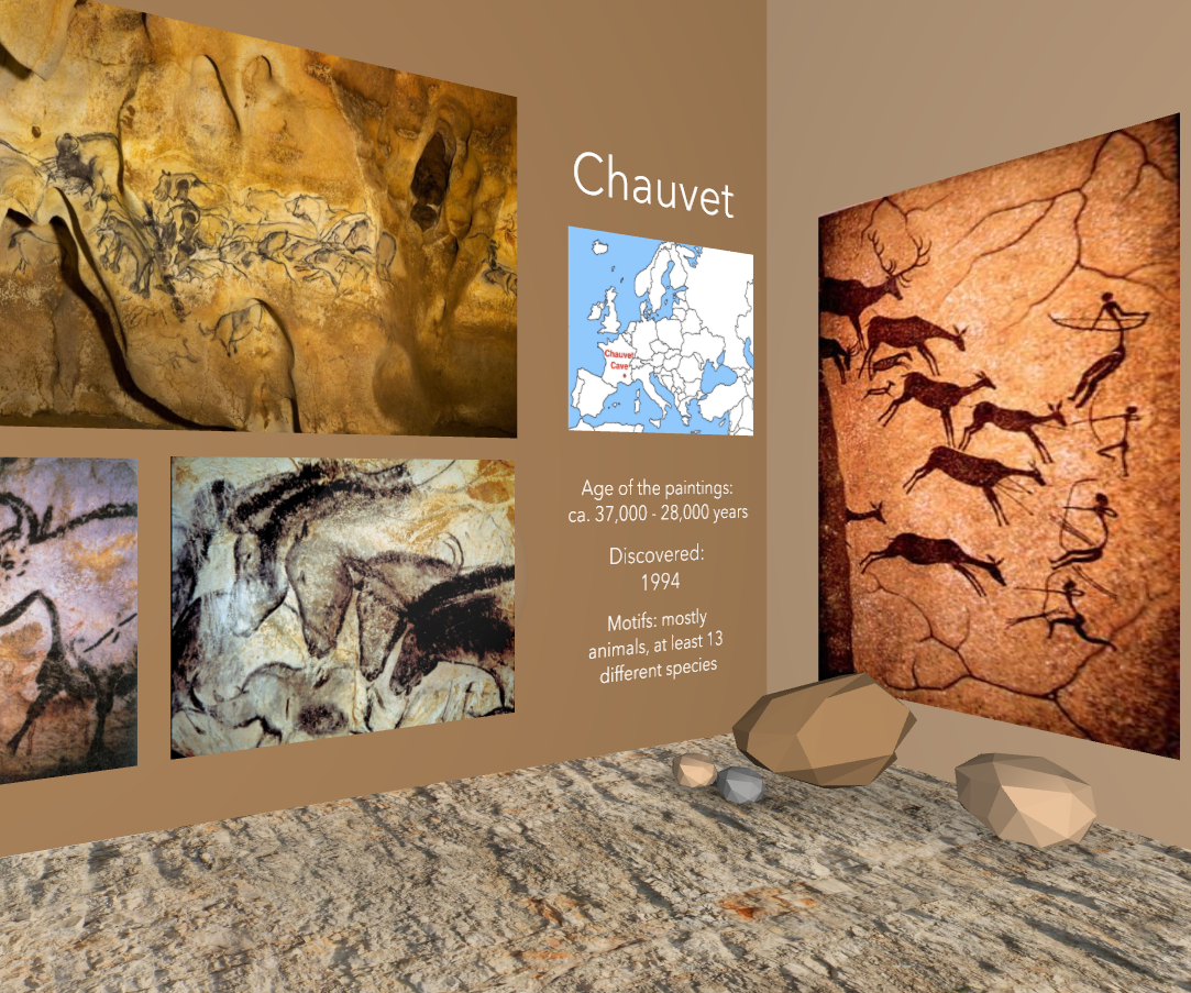

Step 6: Add a Background
Once you have added all the facts you want to present, take some time to design the surroundings. You might want to choose a background environment that fits the theme of your infographic or add a few objects that work as decoration.
Also put some thought into how you arrange the objects on the stage. For infographics that are supposed to be explored in virtual reality it makes sense to arrange them in a circle facing the middle. By the way, rearranging objects is easier with the grouping or multi-selection feature.
