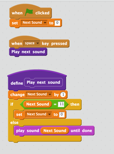

Another way: Defining a Block and/or Creating a Variable
Watch Video Part 2
Picture 2: Define a block: Did you know you can create your own blocks in Scratch? By making and defining your own block, you can have even more control of your programs! Watch the video to learn how to define your own block.
Picture 3: Create a Variable: In the "Data" palette, you can "make a variable" that will help you control when your creation speaks! To use this feature, follow these steps:
- Create a variable called "Next Sound"
- Set "next sound" to zero at the start of the game.
- When a key is pressed, change your variable by 1.
- Use an If/Else statement to control the sound effects. If the variable is larger than the amount of recordings you have, set it back to zero. Otherwise, play "next sound" until done!
